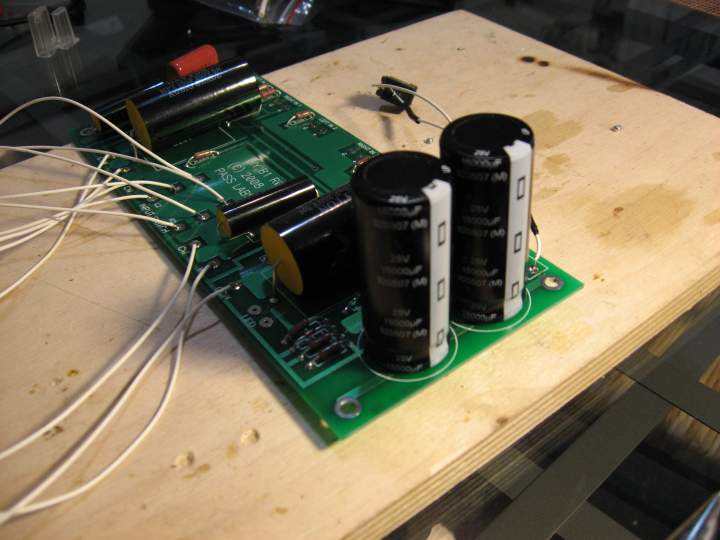

Power supply Caps.
The white stripe = Negative So do not have the white stripe facing the '+' on the PCB.
If you are using the Jim's Audio Ebay PCB, the white stripe on his pcb = negative
well for all intents and purposes the build is done. All that's left is wiring the input as you see fit and using the enclosure of your choice.

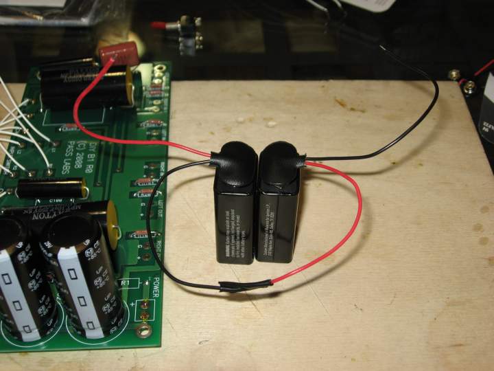

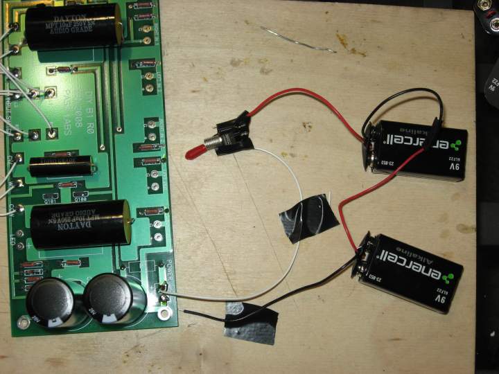

Here's one way using 9v batteries.
2 9v in series for a total of 18v.
Note the wiring of positive (red) to negative (black) from one 9v to the next
to make the necessary 18v.
With batteries you'll certainly want a switch. So wire the positive lead from the 9v to the
switch. And then from the switch to the '+' positive on the pcb. The negative black
lead from the 2nd 9v is then wired to the negative on the pcb.

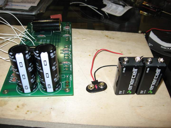

I have some battery holders that I used for my Hagerman Bugle. I can swap out the power jack and show the battery holder wiring for those who want to try that. I'll post pics later tonight.

« Reply #89 on: 12 Mar 2010, 01:29 pm »
Some photos of my battery setup.
Mariusz
Re: Nelson Pass B-1 preamp kit
« Reply #90 on: 12 Mar 2010, 02:24 pm »
What is the 2nd BPS for?
Cool setup.  :drool:

It may be one battery setup for the PS and one for the remote.  Maybe?
avionic
« Reply #92 on: 12 Mar 2010, 02:31 pm »
Cool setup.  :drool:
Mariusz
Lightspeed Attentuator
Mariusz
« Reply #93 on: 12 Mar 2010, 02:36 pm »
Looks like it.  :scratch:
