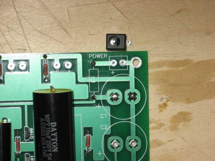

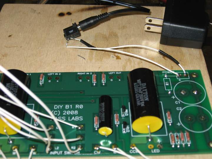

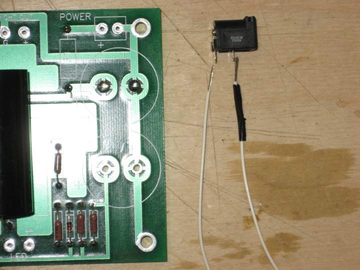

This is continued from the reserved spaces on Page 3, so for those currently following right now you'll want to head back there.
Power jack
Black wire = Negative White = Positive center
Obviously white wire goes to '+' on the pcb to the left.
Waiting for the new PS caps to come in and then this is pretty much done!
