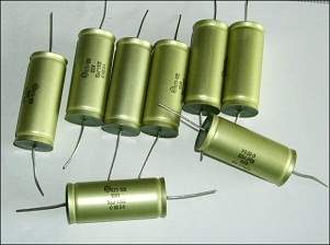

Well I pulled out the 22ufs. They were too bloated, but hey it was worth a try. I dropped in the 10uf Russian PETP caps that arrived today, and what can I say, I think they sound pretty. freakin'. good. Right off the bat. Not what I was expecting. They're kind of sweet, good detail. Tingly. My B1 has never sounded better. I think it's mainly due to the matched fets and my AC choke filters, those really improved the performance several notches.
I was going to build the DC Coupled B1 on diyaudio next because it's supposed to be better, but I like what I hear so much now I think I'll call it a day. My tweaks on this 'r done. :smoke:
Ya right! :eyebrows:
Good work, i am using some russian pio's with excellent results also.
