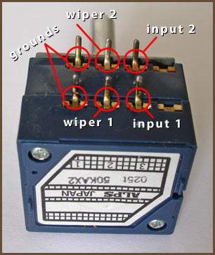

Question about the input switch.  How do we know which lug is right and which lug is left output? Which side is source 1 and which one is source 2?  Or it doesn't matter as long as I am consistent with L and R - like all Ls on one row and all Rs on one row?
Btw, for the Alps Pot, is the G O I the same layout as PEC pot?  like from left to right, G -> O -> I when the shafe facing me.
Thx!
Thx!
