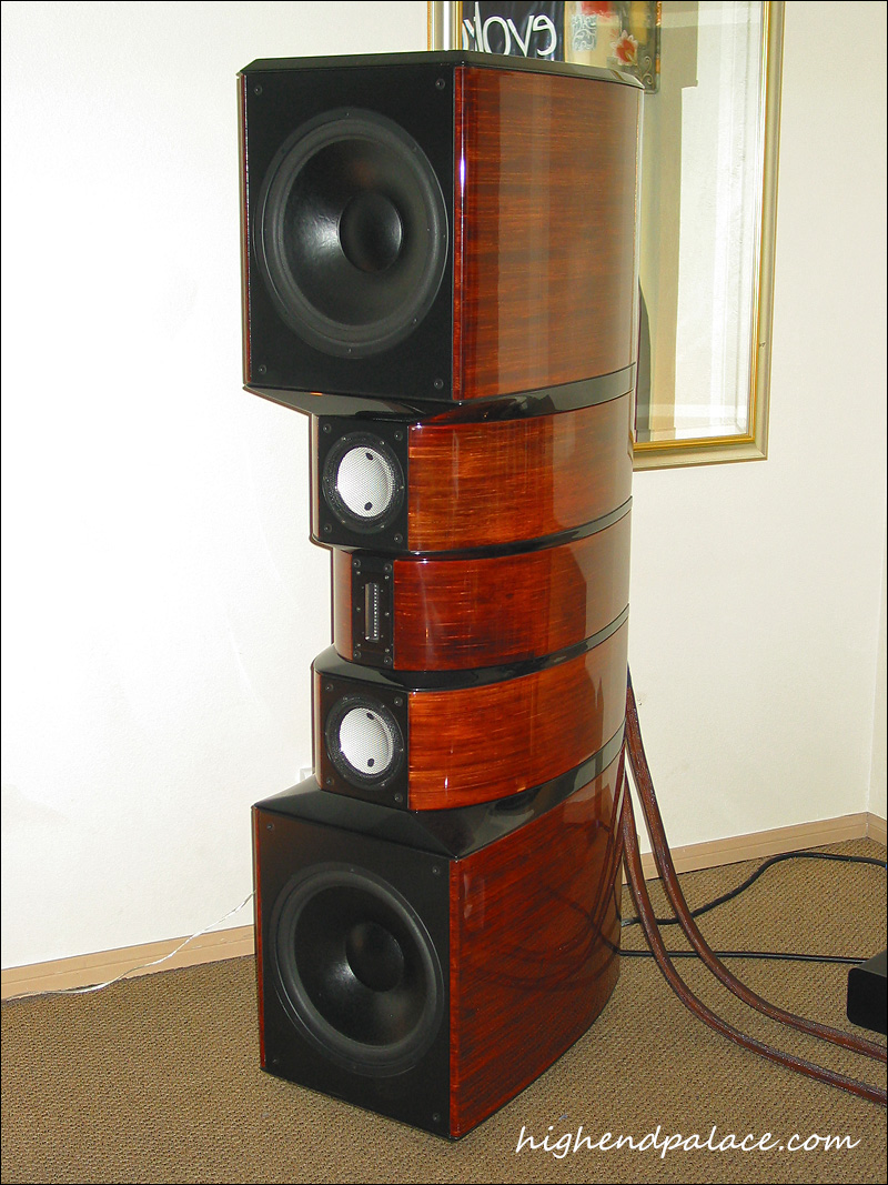

Thought some more about the color, that red above (and below) is too much, I think a more neutral wood color would be safer long term. I'ts probably just that years ago I fell in love with a pair of headphones with a similar finish:
Nice on headphones, maybe not a major piece of furniture though, I want others to enjoy the looks as much as I will enjoy the sound :)
I want it to be easy clean and low maintanance with that hard glossy surface though. Probably.

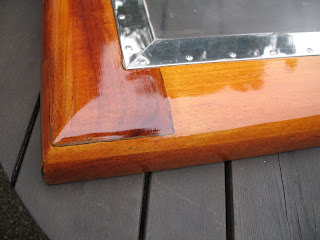

As for wooden boat look......most are sprayed with West Marine Epoxy with a cover coat of uv enhanced varnish.....it doesn't get any tougher.....if the Navy did not have o much surplus grey, this is the way they'd go !!
Nice, found this pic:
http://fredbinghamcutter.blogspot.com/
Looks great, more reading to do!
