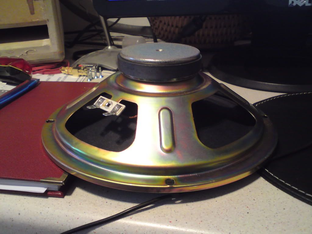

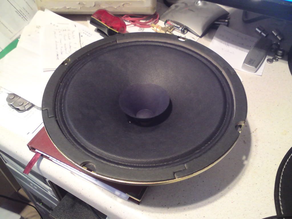

these drivers look remarkedly like the drivers I am using in my open baffles. I bought mine on ebay uk and they were £55 a pair. I have talked with the seller on several occasions and all he has said is that they are 10w and 97db and that he purchased all the drivers available in the UK, I assume it was in the UK anyway. They may be the same drivers and he didn't want me to find where to buy them cheaper. If anyone is interested I will post pictures of front and back.

Please do versus!.........................I'll probably take a photo of one of my drivers as well :thumb:

Thanks versus.
Yes that looks like the cheaper driver of the two available here in Australia.
It should sound pretty good though?........................how do you find it in efficiency and tonal balance?

I run them with 2A3 set mono's at 3.5 w they are plenty loud enough in my 5m x 5m room. They are not far short of the lowther EX3's I was using in a fidelio cabinet with better bass. Very flat response and very little of the shouty peaks I got with lowthers and thats straight out of the box. Unlike the lowthers that still were bass light after 5 months continuous use. I may try these redback drivers as I am looking for a driver to use in open baffle when I start to sell them commercially after very favourable comments from those that have heard them.
