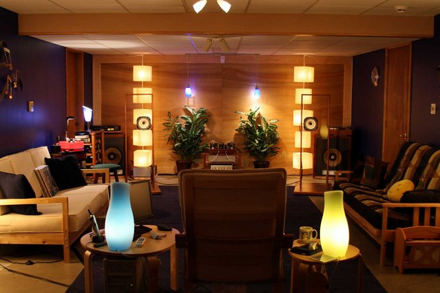

Next is that an open baffle speaker loads a room differently than a traditional box speaker. Since you have sound radiating and reflecting in all different directions by design, you don't want to over damp the room and eliminate the primary reflections. IMO, that is where you get that monster soundstage that I experience in my room. Just to give you an idea, MerRev (one of the local guys) and I played with the size of the decorative plants located just inside the plane of the baffles on the headwall (see pic)
Believe it or not, we ended up reducing the size of the plant by over 50% because the larger plant made the soundstage collapse. You can see the size of the plant we ended up with in this pic.
Next you can see where I used plants on the headwall corners to help diffuse some of the bass buildups in the corners. Though not as effective as a trap, it does have an affect. I do use plastic/silk plants throughout to help diffuse rather than absorb. I've found that the first sidewall reflection being diffused seems to help with focus.
So between the ceiling tiles and diffusion that pretty well takes care of the high frequency anomalies that happen in my room. Now we are left with bass nodes and nulls. That one was fairly easy. I sat myself on an office chair with rollers and played the same song over and over as I rolled back and forth until I found a place where the nodes and nulls were minimized. That said, where my listening chair is, I do get a bit of boost below 50Hz but that doesn't bother me a bit. In fact I rather prefer it that way.
