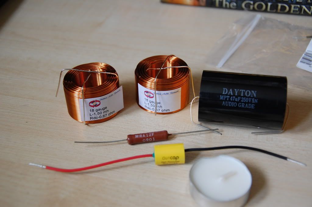

I am a little confused after the discussion on the AN8 cross overs.
Parts list; I have the existing 150uf caps as well as the following.
2 x 4.5Ohm resistors
2 x 8hm resistors
2 x 1.5 inductor
2 x 47uf cap
2 x 240w plate amps
Thanks a lot
Ian

Okay, I am concerned a little bit with the quality of the caps.
We need to protect your full range driver from the low frequency ranges so it won't get beat up, but the entire signal will be passing through whatever cap you use so it needs to be of good quality.
I also always by-pass any large cap value like that with a much smaller one. My favorite has been the little .1uF Gen.2 Sonicap. In 200 VDC they are only $2.70 each so it is not a big expense, but it really helps reduce any cap related smearing.
Can you send any pics of that stuff?

Hi Danny,
I included the .47uf Auricaps and tea light for size comparison. The 150uf currently in line with the AN8 is made by Mundorf and was very expensive.
I have also been a real idiot, i forgot to check if the plate amps run on 240v mains. I just assumed they would be switch-able, doh!
120 VAC, 60 Hz, 400 watts, is the spec listed in the manual.
Should i buy a step down converter unit or an actual transformer with two 120v secondary outputs? i can only find step down unit rated to 200watts, do these plate amps really pull 400watts?
Danny, do you sell the .1uF Gen.2 Sonicap. In 200 VDC?

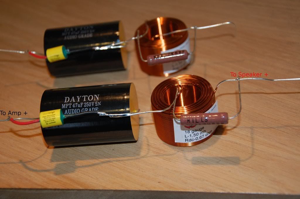

Okay, hook it up like this:
I didn't have the high dollar Mundorf so I used a 100uF Erse in its place so you can get the idea.
If you have some of those small Auricaps like the ones pictured then you could use them as by-pass caps hooked up like shown. This will help out the quality of the sound a lot.
Yes, I do stock the .1uF 200 VDC Sonicaps. They are only $2.70 each. I don't have them up on my site or I would be constantly filling orders for two of them. I'll do anything I can for my customers but would not like to advertise a lot of orders that will make me less than $2.00 profit for all the time and effort of packing them up and providing an invoice.
I also stock all of those other parts and/or anything else you might need.
The size of the Mundorf cap that you have (150uF) might be too large and still allow the driver to be worked too hard in the lower ranges. You'll just have to play it hard and keep an eye on it.
Does this make sense?

Hi Danny, can i just clarify a few things.
The 100uf you have pictured, I will use the large Dayton 47uf.
Bypass the 47uf with a small cap, i have two tiny AURICAP, .022 µF, 600V as well as the .47uf available?
Should i use the 8 or 4.5 Ohm resistors?
The 150UF Mundorf cap in series with the positive speaker connector?
Thanks very much, just ned to sort out the voltage on the plate amps now.
I'd try your Mundorf cap in this place at first and see if it blocks enough low frequency information for you.
If it does not then I'd try something along the 100uF range. You could try a pair of those Dayton 47uF caps to make a 94uF value and see how that works.
Whatever value you use there, by-pass it with your small Auricap.
Start with your 4.5 ohm resistor and see how it sounds. Top end too hot, go with a larger value. Top end too soft, go with a smaller value.

Danny, I did as you suggested and tried some very bass heavy music. The excursion was more than i expected, with a suprising amount of bass output. So i have used the 47uf with two tiny AURICAP, .022 µF, 600V bypassing.
Also used the Mills 8Ohm resistor with the Jantzen 1.5mh inductor.
As I'm not currently using any resistors, just the Mundorf Cap, do I need one back in situ, or just wire it up like my photo?
Cant wait to try the new xover, just want to check with you guys before blowing anything up.
Many Thanks
Ian

Hook it up just like you have it wired in your photo.
If the top end is too soft then you can start reducing that resistor value a little to bring it back up.
It is going to sound a little different now if you have gotten used to it the way it was, but it will be much more accurate.

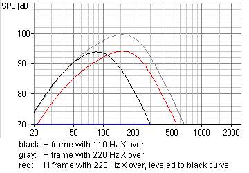

So I have a question for the forum. Rudolf mentioned the low pass should be tuned to 110 Hz to suit the Beta 15's and i am currently using passive 8 Ohms subwoofer filters Crossover frequency 120Hz,12dB/oct. ( 1 inductor & 1 cap).
Can you suggest  passive components better suited,making a correct type and value filter?
