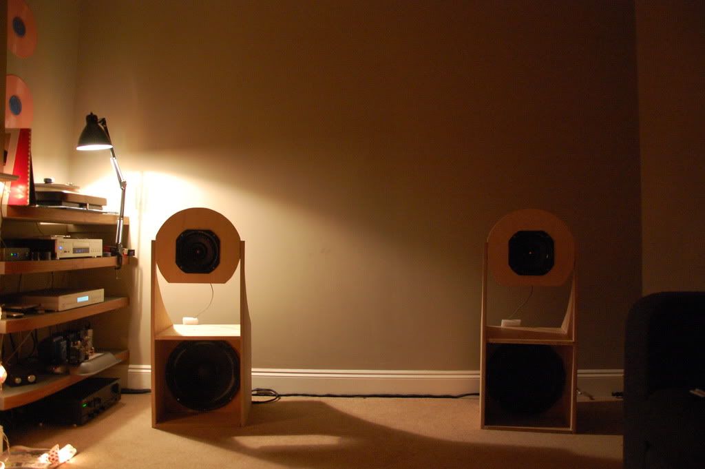

That looks like it will give you a lot better results.
Next is that they are so close to the wall that the reflection will sound like a time smear of the original on axis response. You need to get them a good 3 feet or more off the wall so that the reflection will sound more like a delayed reflection.

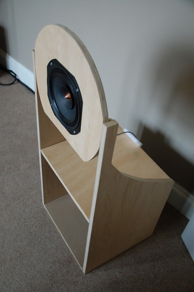

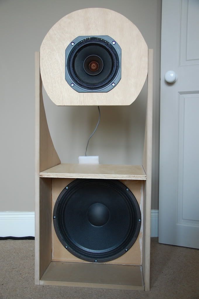

Ian,
while this should be a big step forward compared to what you started with, this will NOT give you better results than the simple rectangular baffle I already recommended for the AN:
The fully circular baffle will rob you of some dearly needed efficiency below 200 Hz, it will emphasize the peak from 500-1000 Hz, and it will add a dip around 1600 Hz.
Pink is the rectangular baffle which I recommended, red is the same but with the top like in your present  baffle (if you prefer the looks).

Ian!!!
Love the photo with the desk lamp providing a single angled light source for the picture- very dramatique'
What are your plans for finishing?  Are you going to stain, paint, incorporate that fabric you started with?  I would vote for something clear and durable on the bottom of the circle to the top of the H-frame and then take that fabric you started with and cover the circular baffle.
And I agree with Danny.  Make sure you pull those out from the wall at least 3ft.
Nice aesthetics on that! :thumb:
