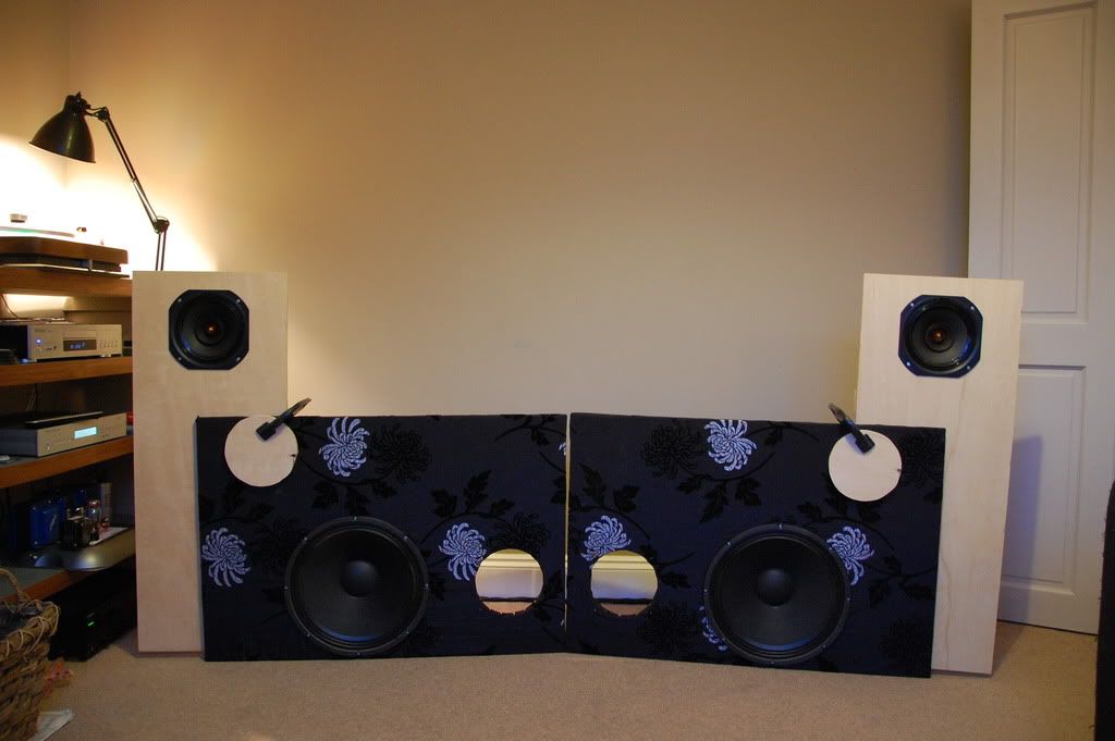

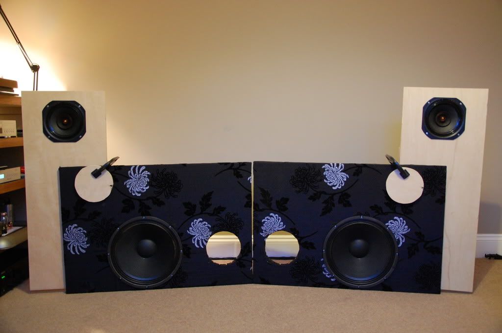

Hi All,
I have been busy,take a look...
This allowed me to try out the narrow front baffle, without hacking up the existing baffles.
The outcome is the Dipole effect is much more obvious, before the wall reflections were being stopped by the wide baffles.
So narrow baffles it is!
Martin, would you please elaborate on the baffle position. I was taking / stealing the layout ideas used by GR research super v or v2 models, I think aesthetically speaking, my wife is much more inclined accept a clean front baffle.
She asked me if the Beta could be mounted on the ply front baffle as it is now, I said I would ask the forum if I am allowed and get back too her  :D
Could I put the beta frame on the back without compromising bass too much?
Thanks

Re: Where next on my Open Baffle adventure, Advice please.
« Reply #34 on: 3 Mar 2010, 02:48 am »
Sorry, I am a little late coming to this thread.
I have been there done that already with all of this stuff and know what you are up against. If I would have caught this thread earlier I would might have saved you some trail and error lessons. Sorry...
I also have measured and tested it big brother the Super 12 in open baffle application. So I have a good idea of what you are up against there.
First off, get your baffle size down as small as possible. The surface reflections of a wide baffle will kill your imaging and any transparency aspects of the sound stage. All will sound as if it is playing from the baffle forward.
If you need to, turn your lower woofer sideways so that it doesn't add baffle width.
Try something like this:
Also, I would highly advise against a U shaped frame. Most utilize them with no bracing at all. Then the panel size is such that they flex and resonant wildly. At least the H frame breaks the panels down to half their size. That helps a lot, but can still be a problem. Even a friend of mines Orion's allowed a LOT of low frequency coloration due to panel flexing and resonating. I used 1.25" thick side panels on the Super-V and it still needed to be lines with No Rez to kill the resonances completely and provide a solid bass response.
Another thing that I saw in this thread that was a red flag was this compensation network for the Super 8.
Do NOT use a resistor at the front of the network allowing a full range signal to pass through it. With very little power on it at all, it will burn up in smoke and flames.
