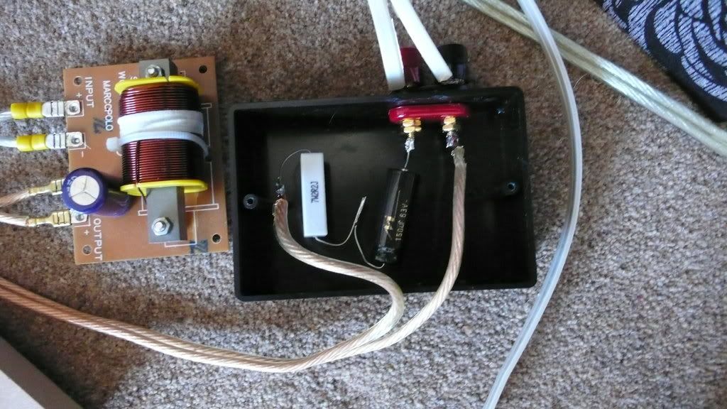

I will try and fill in some  details, the AN has a 150uF Mundorf capacitor, crappy 4.6ohm 7watt wire wound resistor. AN spec sheet;
Although I have heard the spec is not accurate, but have no measurement equipment or software.
The Beta 15 has a Passive 8 Ohms subwoofer filters Crossover frequency 120Hz,12dB/oct.

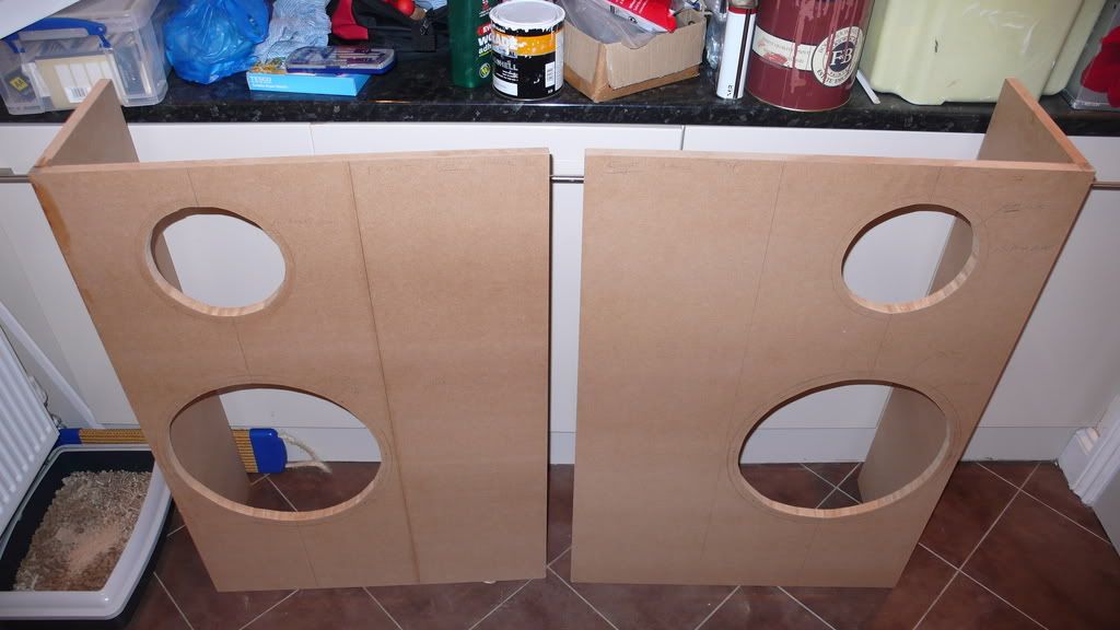

Baffle details, panels cut to 38"x10" and frony baffle cut to 38"x16"
As you can see the side panels are 10” deep and only one side, so I have more wood available to make the H frame deeper if need be.
In the OB article above it discusses “The distance to the top of the baffle and also the shape of the baffle top, does seem to have a greater potential for effecting the final sound. This is a bit more involved with the soundstage illusion and will be covered more in the next section. For now I would say that it is generally considered prudent for this distance to not be our shortest. If the shortest distance to an edge is this top dimension, some suggest that the sound will interact in this area first and have ill effects on soundstage. We also have seen good results from making these top sections domed or sloped. “
What do you think to this suggestion, also putting felt on the rear of the panels?

The sub woofer filter is ready made, Crossover frequency 120Hz,12dB/oct is the listed spec on the manufacturers website.
http://avslgroup.com/product/900.584UK So I don't know the capacitor and inductor values, sorry.

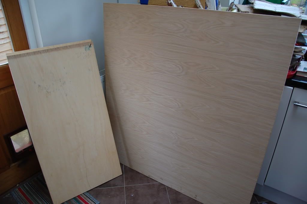

Ok, I had some free time. Popped down to my local wood yard to collect some oak veneered MDF. I asked them could i have a look at some off cuts, found two pieces of 18mm birch ply about 100cm x 53cm. How much governor? Take em, he said!
So now the possibilities have really opened up.

You will need the three parts for the notch filter and you should retain the 150µF cap and the resistor. In connection with the plate amp they will be part of the different choices you have to get the best crossover between both drivers. More about that later.

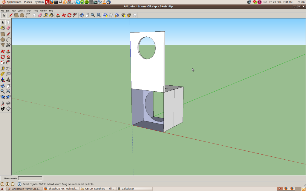

Hi Rudolf,
I can waste as much time as you have, thanks  :D
I have been learning Sketchup to help design this quickly, my friend is a auto cad / 3DSmax guy and offered to model it properly next week.
But just to give you an idea.
The H frame box is 40x40 and 40 deep with the beta in the middle.
Front baffle sits on top and is 57cm high, with the AN centred at 32" with 15cm to the top of the baffle. This sets the AN centre the same as the current baffle, around ear height when sitting down.
I will make some side panels to add rigidity and blend the H frame and  front baffle, with a cut out meeting near the bottom of the AN.
Any suggestions, or changes to the components?
The parts express sale ends Sunday for the amps.
Many, many thanks
Ian

Rudolf-
What's your thoughts on this OB plan for use with the AN Super 8 Alnico?
Dan
Rudolf
Re: Where next on my Open Baffle adventure, Advice please.
« Reply #18 on: 26 Feb 2010, 09:49 pm »
Hi Ian,
Sketchup is good enough for me anytime.
Your design is approved. :wink: The crossover between the drivers will be 200 Hz max, so pushing the baffle to the front of the H frame will be no problem.
I am a little bit concerned that the side panels might get to high up. I would not let them extend beyond the straight red line in any direction. Something like the curved line would be very ok.
If you are thinking of side panels like on Linkwitz' Orions - they are only second best for stability and will make the baffle wider. Then we would have to calculate a notch filter for a U frame geometry -which I can't simulate with sufficient precision.
If you are concerned about the rigidity of the forward baffle, you should think about a central spine behind the AN. It is always better to stop unwanted motion, where it it generated, instead of 20-30 cm away.
I thought the PE amps had been ordered already. There are really no caveats about them from my side. If you need side panels as deep (or deeper) as those on the Orions you better wait with the filter components until a final decision and source them locally. There should be some electronics component shop even in London. :lol: The component values already given will be fine for the baffle as shown.
This starts to make fun. I'm just getting MJKs worksheet for the H frame and OB combination. So i am pretty shure this will become a quite decent system.
