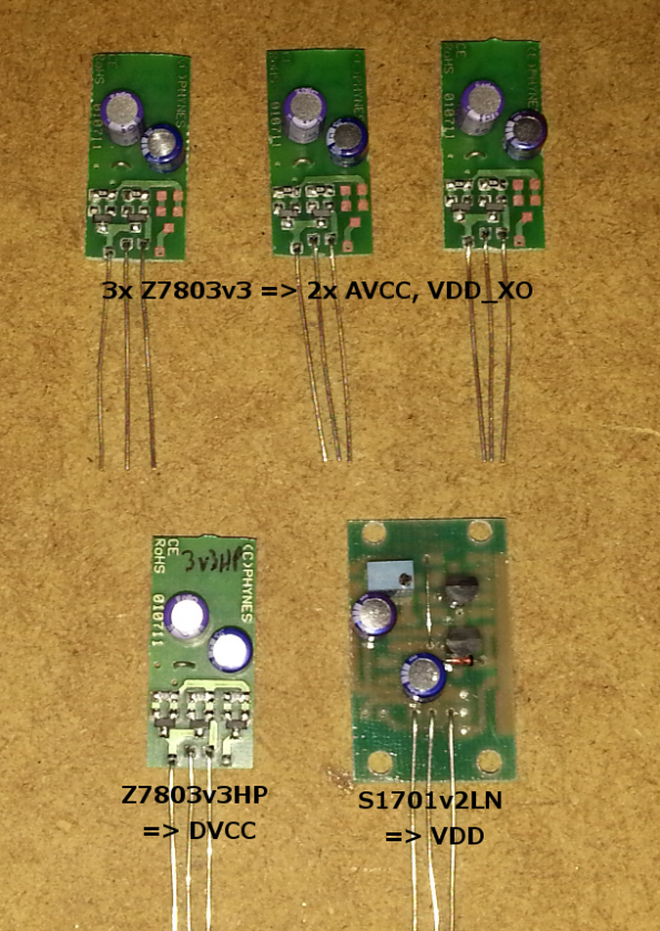

Hello! I have a complete Buffalo III + Legato regulator kit. I am not 100% positive on how to connect it all together, though, and would really appreciate it if you could answer my four questions below.
My Canterbury Windings transformer has 4x 0-18v secondaries that I plan to use as follows:
red-yellow  => NR3-15
black-white => NR3-15
green-violet => PR3-15
orange-pink => PR3-15
For the PR3-15, it is straightforward - two secondaries go naturally in the 4-pole terminal block.
Question 1) For the NR3-15, the "CT"/center tap connection in the provided info sheet is a bit vague, and I don't want to destroy anything. Is the following correct?
Question 2) Also the small regulators are not so clearly marked. Is the following correct?
Question 3) The small trim potmeter on the 1,2V S1701v2LN is for adjusting the output voltage, is that correct?
Question 4) The small trim potmeter on each of PR3-05v4, PR3-15 and NR3-15 are also for adjusting output voltage?

Hello Bogotronix,
1)   your drawing is correct
2)   you have identified the modules correctly
3)   and 4) the trimmer potentiometers do adjust the output voltage over a limited range to allow accurate voltage setting. Be careful not to do this adjustment on the 1v2 reg while in situ on the Buffalo Board as it would be possible to over-voltage the dac core if you turn the pot screw too quickly.
Regards
