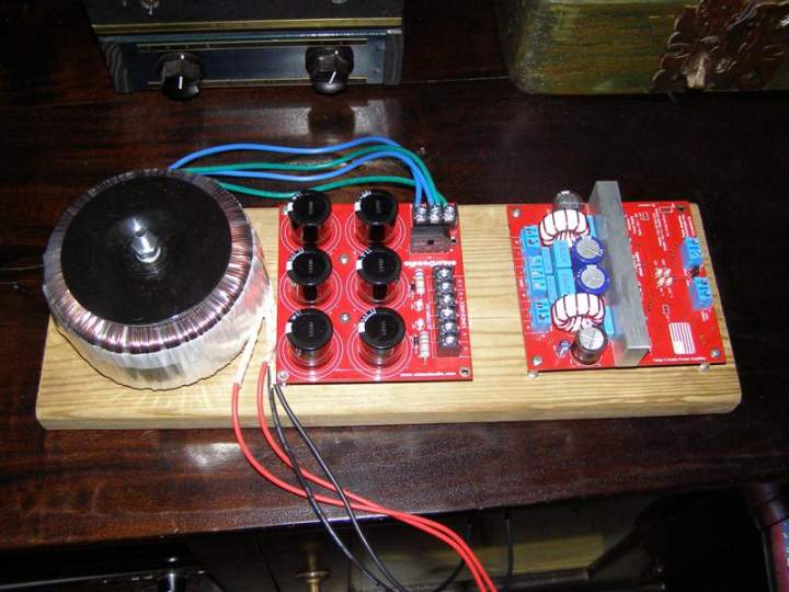

The Primary Election in Texas is over and my client won.  Now I get to move on to the really exciting stuff when my extra parts arrive...probably on Friday.
Anyway, here's what I have so far and I'm looking forward to wiring this puppy up and hearing what it sounds like.

Looks awesome, i think you will be impressed. Are you still running the single driver speaks?  :eyebrows:
I don't think you will be dissapointed.  I have about 90 hrs on my 120x2 and it is sounding sweet! :thumb:
Yep, still have the Omega Bipoles and am really looking forward to what a little extra power might do.  Running them like I do, in bipole mode, will produce an 8 ohm load, which will double the 30 wpc I now have with the Sig 30.
I don't remember exactly what my system comprised of when last we spoke, but now it's a Bolder modified Squeezebox III into a Burson buffer, to a Mapletree pre, to the RWA Sig 30 and out to the Omegas.  I think with the buffer and the pre I'm going to have some latitude in setting this amp up to perform at its best...at least I hope so.
