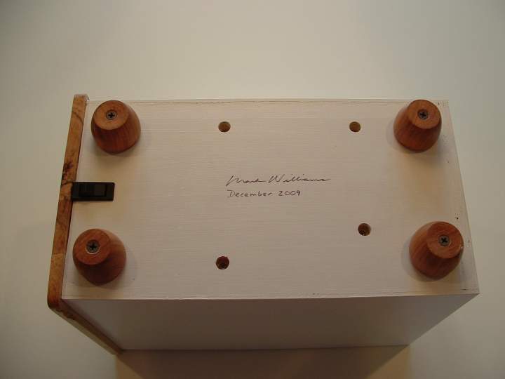

Here's another case built by my buddy Mark. The face is spalted maple and the feet are cherry turned by Bob, the lathe master.
