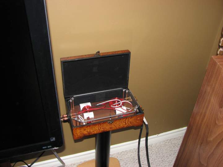

It's been a while since anything exciting has happened but the Ninja has finished my outboard crossovers and they're in the (gasp) mail. He sent me along this pic which is much like showing a piece of art off without taking the canvas all the way off. Can't wait to get them so I can decide on a final pedestal for them.
I'm off to the east coast in 14 days to visit the in-laws and finish off the cabinets!

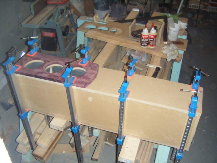

Ok. I'm on the East Coast, weathers been not so conducive to golf so we've pounded in some good hours on the speakers. The wifes on her way back here but I've got a few minutes to post some pics so:
First the Team:
That's John on the right and myself on the left. Like the zoot suits eh!!
We've been using biscuit joints to put a lot of it together. For the speaker baffles I'm going with Purple Heart.
Stuff ways a ton and is hard on the blades!
I laid out the No-Rez as per somebodies cut sheet but that didn't add up. I had more than enough in the end though.
The wife has shown up so one more pic untill tomorrow(ish)
I've learned a lot so far. Amongst other things: the devils in the details!!
Dave

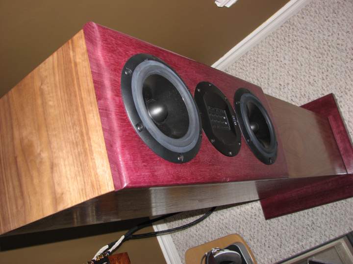

Here's a couple of pics of the rough finish before they get crated for their journey home:
Lot's to do yet but it sure nice to see it this far along. The table to the left there has a finish of what I'm looking for. Any thoughts on where to go from here to accomplish that would be most welcome. The veneer is Walnut with several layers of poly clear coat at the moment.
Dave

Looks like you are making good progress Dave!  I hesitate to ask at this late juncture, but the width looks wide (probably due to the contrast of the Purple Heart and the black/gray of the drivers), they are 8" outside width, correct?
Best,
Ed
Light-Echo
Re: Christmas! (A GR N3 build)
« Reply #32 on: 3 Jun 2010, 10:44 pm »
Crazy good eye Ed ....  The speaker cabs are 8". The baffles are 8 1/8' - a 16th over on either side and the top. We weren't absolutely sure how much to allow for the veneer so we left a little and were at one time going to flush router it even. We had a nasty experience though doing the bevel on the top of one and had to do some surgery to repair the damage. I haven't clear coated that baffle yet, just the speaker. We'll see how it turns out.The Purple Heart grain is pretty wonky in places. We decided not to chance flush routering. It looked pretty good anyways. How did you do yours?

Ahh, good Dave.  I was afraid it was wider than that.  I don't think it was so much a good eye as I was just mistaken.
If I remember correctly I believe I made my baffle with just about 1/16" reveal on each side, so my baffle was just a bit shy of 8".  Not necessarily right, just the way I did it.
You're in for a treat once they have broken in a bit!  Enjoy!

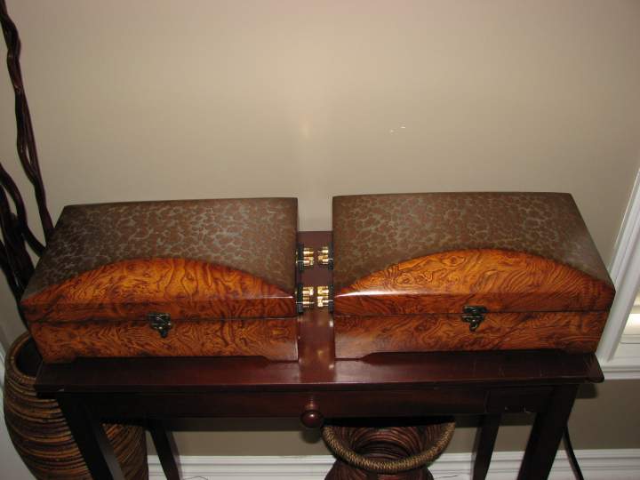

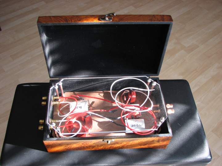

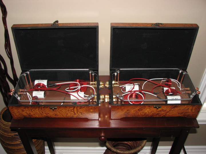

I'm a picky old fart and it took me a while to find the right boxes for the N3 cross-overs that Sean built for me. I think I nailed it. I haven't soldered the posts yet and it will clean up better than what's shown. I left extra so I could pull the wire through the box a tad to do the soldering on the outside as I have no soldering skills that I'm aware of.
S'cuse the dust
(A bit later....)
Regards
Dave

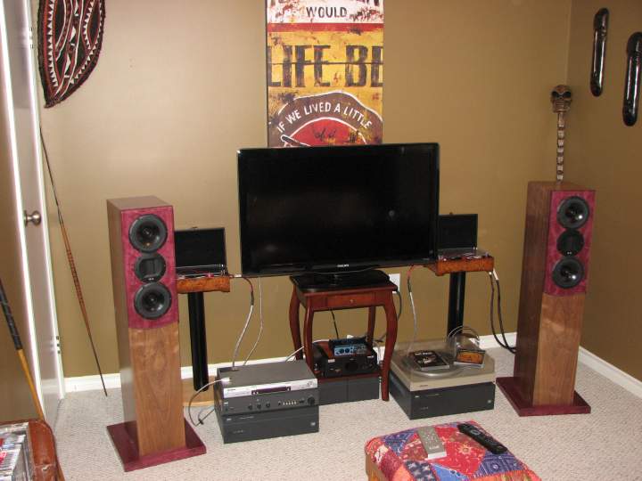

« Reply #36 on: 27 Sep 2010, 12:35 am »

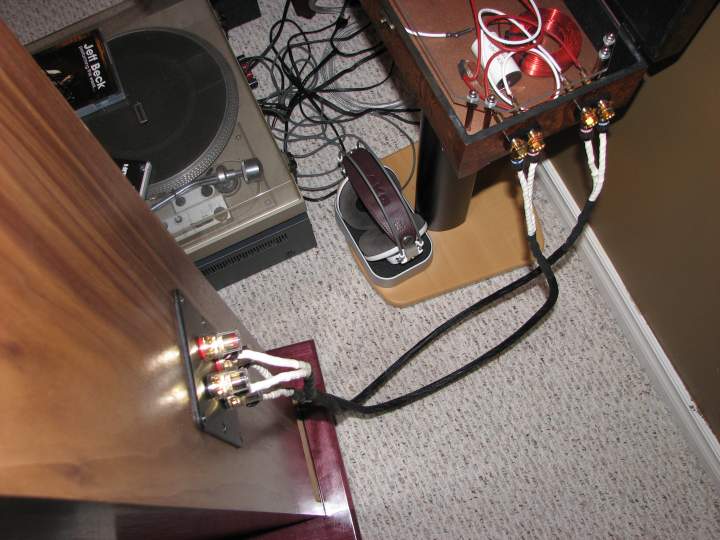

Close to a year in the making, all this. Actually it probably started a long time ago, this fetish of mine, but it's taken on a life of it's own recently that I'm sure many of you can relate to. I have my listening room set up quite nicely, and I know there's lot's I could do to make it better ... room treatments and the like. But it's so very cool and I love my wife dearly for putting up with my passion. I most certainly will be upgrading equipment sooner or later... now and then.... speakers, amps, dacs, wires, stuff. But I need to say a few things about the N3 and the M-901. What a friggin incredible speaker. What an equally wonderful amp. I know this is Danny's forum, but if you really want to hear his speakers perform, the amps that Seth put's out really bring them to life. I had a friend over last nite. A musician. He was somewhat skeptical of my passion. I had him over previously to listen to my K-701's and he couldn't quite figure out why I had spent so much on them.... but last nite he was pretty much dumbfounded by what he heard. I chose some songs that exemplified the system and that I was pretty sure he hadn't heard before; Vienna Tengs 'Gravity', Roger Water's "What God Wants", Sarah Brightmans Gothica - Fleurs de Mal. Then we played some of Jeff Becks new disc: Live at Ronnie Scott's. I can only say that this speaker sucks you into the music. You don't 'see it'. You just hear the musicians. I have a couple of NAD THX certified amps that love to push these N3's, and playing something like La Villa Strangiatto or Parabola is quite satisfying punch-wise, the songs previously mentioned have a much more satisfying presentation on Seths M-901. Here's my sound room today:
The crossovers were built by the Ninja and I put them in those cool boxes. I was inspired by other to build the cables betwixt the cross-overs and the speakers. I'm pretty proud of the whole set up.
Please excuse the mess of wires back there.
The M-901 on battery power simply blows any  PSU out of the water by the way. NO background. Nada.
