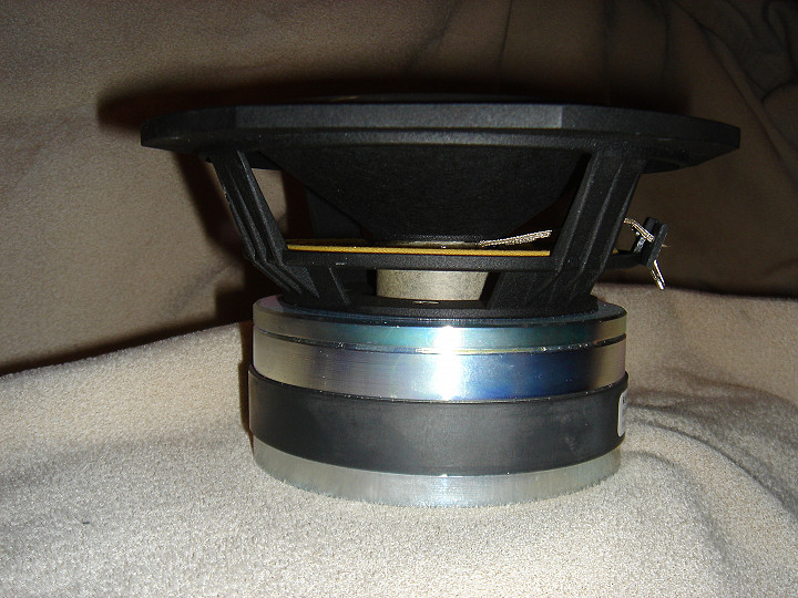

« Reply #17 on: 1 Jan 2010, 08:24 pm »
Thats a great looking speaker Kevin. I am excited to see a new 180mm speaker with XBL technoligy. I could have sworn I have seen that motor before. I took a picture of one of my drivers from a company that is no longer around just to compare. I look forward to trying your new driver in 2010.
Raw Acoustics LXII driver below
http://www.diycable.com/main/images/Anarchy/WebPics/A3.jpg
Best of luck in the newyear.
Yea... I miss hearing from Al.   I'm not privy to the details of Al's woofer.   I think it was a higher BL high-efficiency unit rather than a low-reaching stroker.   The motor looks larger/higher B than the Anarchy.     Like anything you have to pick your poison when you design something.    High-efficiency means less bandwidth.    I've picked a spot somewhere between the Extremis and Al's midwoofer.    It is pretty much the same as my EX-6.5 which I felt was a good balance point for box size, bandwidth and efficiency for this size device.
I'd call the Anarchy an evolution of the earlier designs.   It makes the same tradeoff for box size, bandwidth and efficiency as my EX-6.5 but adds more usable stoke and much better performance in terms of usable upper frequency bandwidth due to the clean response.   It has more suspension capability than any of the previous designs which translates into better behavior in overload situations and cleaner performance at the limits.   The most difficult thing though was getting the good clean midrange performance PLUS all that usable stroke.   The two are difficult to combine as you usually have a tradeoff one for the other.
