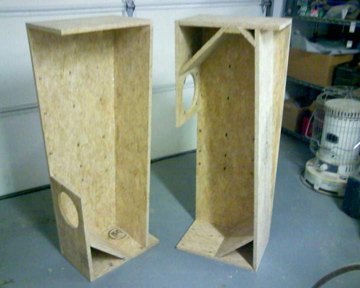

Let me start again.  I worked all weekend on the Dallas II's.  I took pictures and put them in the gallery ( the ones that weren't blurry).
Long and short of it is this:  I added 3 13/16th" ( the distance from saw shoe edge to the far side of the Kerf ) to  17 11/16th", and forgot to carry the 1, making a gauge block that  rendered 16 11/16th" cuts.  I beboped along not realizing my mistake until I'd cut out the sides, and bottom of the cabinets....an inch short...GaaHHHH.
Not to worry, I found a piece of Pine, and glued it to the short pieces ( in the back where it won't show ).  I only made 2 gauge blocks, the other was perfect, and was used to cut out everything that goes between the cabinet sides, it worked out very well.
The cabinets are all cut out, everything has been given it's first rough sanding, the baffle's are machined, everything is ready to go 3D, tomorrow, and what ever I can squeak out in the shop next week.  This will be another new adventure, I've never assembled a cabinet with glue and brads before, usually I glue and clamp.  I hope the nailer speeds up the process.
I hope all 3 of you watching are as excited as I am.....
Here's a gratuitous pic.

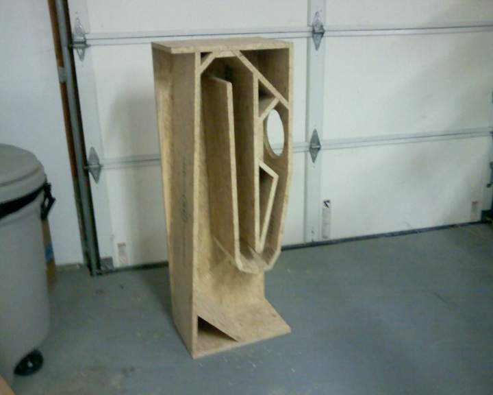

We've gone 3D!
A little bit of progress tonight and last night.
Robert your question about the panels possibly needing to be " evened out" was spot on.  Even though I was very careful in my layout, I am having a few of my pre-cut pieces vary as much as a 32nd of and inch in width.  A few parts came out less than square too.  So far everything is lining up on the baffle nice and even.  I forsee some time spent with a straight edge, and my belt sander before the final sides are attached.  So far it's not looking too bad.  I am using PU glue, so small gaps are not a problem.
5 more pics in the gallery ( yeah, 5 more of his crappy phone cam shaky hand pictures.....).

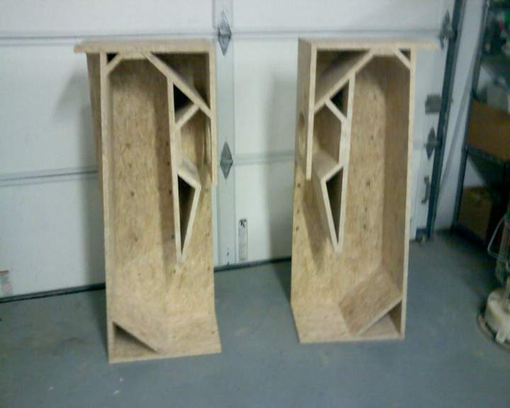

More crappy phone cam pics posted to the gallery.  Here's a tease:
I got a little more accomplished on one of the horns after dinner, but it's not ready for photos yet.  This part I decided to clamp, and not brad nail.  The last board in the mouth of the horn is in ( board directly under the baffle ), and so is the long divider terminating in the second bend.  Next thing to do is install the outer portion of the first bend/ flare to the horn mouth.  I didn't like the way the full size drawing came out here, so I'm re-engineering it to smooth the outside of the bend slightly.  Instead of being made up of 3 pieces, I'm using 4  ( Strike that, it's now 5 I wasn't happy with how the expansion arcs were being followed, now I am).  It still follows the radius indicated on the plan.
Stay tuned....

« Reply #29 on: 28 Aug 2010, 04:59 am »
I got home early today, after working 24 of the last 48 hours, did I take a nap?... No!
Did I check my E-Mail ( well... Yes)
Hey, I  went out to the shop and worked on the project too....
Looks better in person.
Should have both cabinets to this point tomorrow...
