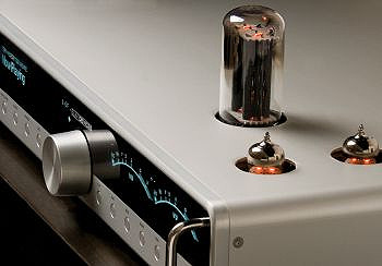

Maybe you could just cut the nipples off the tops of the tubes so they'll fit without needing to mess around with spacers or anything?  :lol:
I'd rather see them poke through like this   :)
I like that too.  8)
I like that too.  A machine shop would cut the holes for a nominal price, I think.

Or you could just whip out a drill with the appropriate size bit, measure carefully, and do it yourself!  I personally wouldn't do it, though, as I'd likely drill the holes in the wrong spot or otherwise mangle the cover in some other way.

If someone does drill holes and gets it right, they could make a template for the rest of us. Or, a small, thin aluminum plate (painted black) could be crafted with the proper on-center measurement for the tube sockets. Then this plate could be affixed over more roughly-cut holes in the actual case. Might could make this thick enough so that the tops of the tubes would be protected. Just some ideas.

That kind of thing always makes me wonder if they got a deal on on the chassis or something. Maybe next time they can use a chassis that actually fits.  :wink:

You could come pretty close by cutting some cardboard to match the height between the chassis and the underside of the cover. Then wrap the cardboard around the original tubes and lightly chalk the upper edge of the cardboard. Gently lower the cover down and you should get chalk circles showing where the tubes are. You'll be able to mark the centers pretty easily from here so you'll know where to center the pilot on  the hole saw.
Measure the new tubes to see how wide they are and then add maybe 1/4" to give clearance. Choose the appropriate hole saw.
Having said that, I'd probably find a local machine shop that was willing to do it. Most of them are looking for work anyway and will make you a deal. They will also do things like chamfer the holes a bit so that nobody slices their finger open on a sharp edge or something.
Frank has given a lot of details on how hard he (and now Wayner too) work on designing good metal chassis. AVA equipment has very nice metalwork.
So spend a few extra bucks to make sure any modifications match the quality of the original work. :)

It will be a little tough cutting/punching holes in a cosmetically acceptable manner due to the existing slots.
