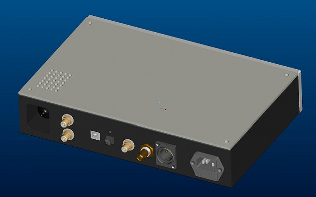

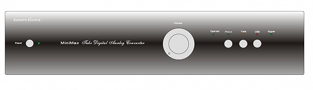

Hi all, I am sorry that I have been running around and did not write sooner. Let me try...
1. The pre-order deadline is Dec 15th
2. The input is selected automatically as soon as one of the inputs senses a signal except the USB which you need to select by tapping a switch.
3. The PS is internal
4. The dimension is 280(W)mm x 180(D)mm x 28(H)mm
5. The hard chassis and accessories are not yet here. Here I attached the drawings for your interest, the finish DAC will look more or less the same.

Thanks for the reply Alex!
However one of your drawings has spawned one further question.  Previously I asked if a BNC coaxial input would be provided, and the answer was no, only RCA coaxial.
But on the rear panel drawing I see what looks like a BNC jack in between the RCA and XLR jacks.
Steve

Hi Steve,
I have finally decided to include the BNC input, sorry for the confusion before.
Cheers !
Alex
What is the priority list?  And if I have a computer connected via RCA and a PS3 connected via optical and if both devices are powered on, I have to power down one device in order to switch decoding?
Would "tapping a switch" allow me to switch between RCA and optical input without powering down devices?

Hello there, my original design is that there is only one input connected at a time and the DAC detects automatically. However, it seems that some of you would like to connect two or more inputs the same time. I am now checking out the selector. I will post as soon as I confirm how I would do it. Thanks for your great inputs which always make our products not only sounding great but user friendly.

Would that be a selector in addition to the automatic selection of inputs? For me the automatic selection of an input is a big selling point, as I can't imagine an instance in which two active signals are entering my DAC.

Hello there, I have spent some time on studying the selection of the input digital sources. I will add an input selector. You can connect more than one active digital devices and they can be turned on 24/7  aa
Cheers !
Alex

if that xlr on the back is a aes input make sure you change it to a female.

While at it, make sure to use a 75-Ohm BNC jack instead of the 50-Ohm BNC jack seen in the rendering..

The AES/EBU input jack will be a female one.
Thanks.
Alex

The BNC input jack is a 75 ohm one.
Cheers !
Alex
