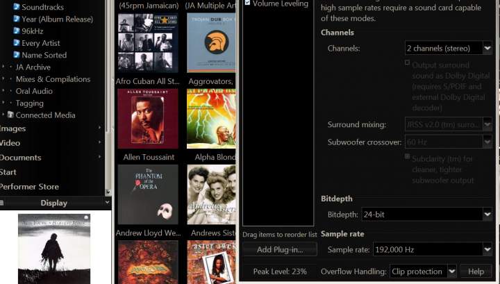

The DAC does not do 192kHz in WASAPI, but does in DirectSound leading me to believe it is downsampled. Also, see Windows Sound Device Properties.

No, but since
  - the TI 2706 USB chip is a 16bit/48KHz chip
  - doctorcilantro reported that 24bit/192KHz doesn't work under the WASAPI driver (although that resolution would require special drivers under USB, but I'm sure he would have the same result with a 24bit/96KHz file)
  - under Windows DirectSound, 16bit/48KHz is the highest possible setting
anything above 16bit/48KHz is obviously downsampled through the USB input.
Steve
doctorcilantro
Re: Eastern Electric DAC
« Reply #319 on: 28 Feb 2010, 04:07 am »
Yes, it's capped at 48; not sure what the DAC does with it though.
