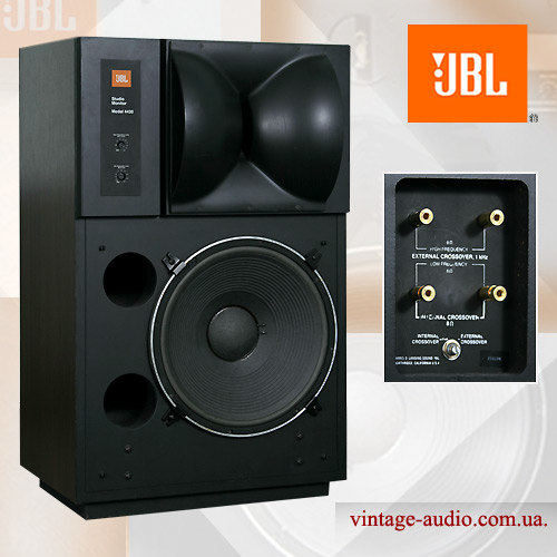

« Reply #18 on: 22 Oct 2009, 03:20 pm »
If you can't fit it in the door.
Agreed, that's my only criteria too. :lol:
Seriously, I've heard very big speakers in very small rooms and I thought they sounded great. Though Tony's comment about "driver integration distance" and coaxial speakers is relevant. In the world of pro audio, "large speakers" are shaped very differently from the 6-foot and taller models you see in audiophile rooms. I have a pair of JBL 4430 monitors driven bi-amped with just over 1 KW of Crown amps. These are huge and old-school like you'd see in top studios 20+ years ago. But they're not tall. More like a half-size refrigerator, with a horn speaker above a 15" woofer:
So even though these speakers are huge, and can play really loud when you want, you don't have to be more than a few feet away to get the proper balance between the woofer and tweeter.
--Ethan
