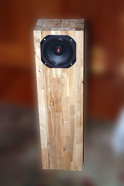

I will try to take some pictures of what I have in mind tomorrow and post it.
If you like the idea, I can try to help you build it.
As to the cost of this DIY project, it all depends on your DIY skills, tools and material choice.
It is quite simple and you should have it mostly finished over one weekend.
Drivers that I am using with these are Audio Nirvana 'Super 6' cast frame ($148/pr).
Material for the box is 1.5" butcher block on sell from IKEA (ask for damaged stock - new might be pricey) and some plywood.
Hopefully you have someone with the table saw, router or skillsaw to make the cuts for you.
If not, any wood shop guy can do it for a nice bottle of Scotch. :lol:
My boxes are as small as possible (32.75" high, 9 1/16" wide & 6.75" deep) - reason? They will go to my daughter's room which has some space limitations.
All in all, very nice sounding speakers. I really enjoy it.

Here is what I had in mind.
Speakers aren't finished yet but you get the idea.
I check the price of butcher block at IKEA - 72"X23"X1.5"  list price($159). That should be enough to make one pair.
Mariusz :thumb:
Mariusz
Re: Speaker selection advise
« Reply #19 on: 14 Oct 2009, 03:13 am »
But away, I am driving them with 2.5 watts and it is plenty.
Depending on your room size, these shouldn't need a sub in smaller to mid-size rooms.
