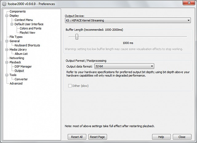

Ok, have the HiFace drivers and Foobar 2000 latest stable version installed on my ASUS Netbook.  Added the Kernel Streaming driver as recommended for the higher bit rate files.
I have been able to playback all the sample rates and bit rates up to 24bit/96KHz without any issues.
Have it connected to a DAC that I know works with the Oppo DV981HD as a transport playing 24bit/176.4KHz DVD-A files.  Cannot playback these files with the HiFace.  Get intermittent clicking noises like it will not lock onto the sample rate.  Even set the playback buffer to 2000mS the maximum recommended and no changes.
Cannot see any other info on what to do to get the 24bit/176.4KHz or 24bit/192KHz files to playback with Foobar.  Still doing some research.

Is the kernel streaming driver ASIO, ASIO4ALL or WASAPI (or something else), and have you selected this driver in the Foobar File > Preferences > Playback > Output?

Odd as that sounds exactly like what I'm doing. I am not using the 1.0 beta of foobar, it's whatever the latest 0.9x version is plus the KS driver. I have the buffer in mine set very low actually, I think 100ms, come to think of it I think it set itself there when I chose the KS from the output, I don't remember changing it. At work using the WASAPI output I did have to lower the buffer but I don't think I changed it for this one. Might have tho.
I have tried three different DAC's and all had no problem with any bit rate including the HRx and Kent Poon 24/192 samples. Be sure the HiFace is not the default sound driver for windows as it will try and grab it for system sounds. Supposedly the 1.02 driver supports windows direct sound so it's possible that the system is trying to use it.
I can screen shot my settings and post them if you like.

I have the Foobar KS driver and HiFace 1.02 drivers loaded.  Have selected the KS driver under the options area in Foobar.

Here is my foobar config, no doubt it looks just like yours. :)

Mike,
Yes,  Mine looks exactly like that.  Oh well.

I think I have found the issue.
If I boot the ASUS Netbook PC with the HiFace installed I have the problem of not being able to playback the 24bit/176.4KHz files. If I boot the PC first then install the HiFace it works correctly.  This is probably why I had problems with Foobar 2000 as I would normally have the HiFace installed at boot.
Probably something about the USB driver and this PC.
Oh well, easy enough to deal with.
