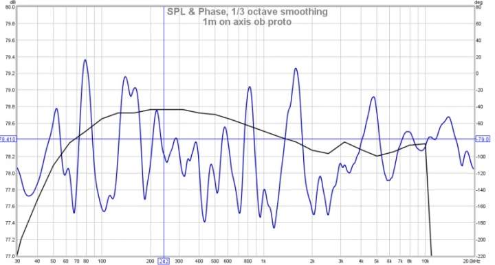

« Reply #30 on: 5 Oct 2010, 09:48 pm »
Hi Folks,
It's been a long time but like all things in life sometimes other stuff gets in the way.
I've Changed direction considerably.  I ran 12 mids per side in open baffle for a few months but they were lacking any real low end although with quite a bit of equalisation the highs were acceptable.
I've attached pictures of my current setup
This consists of 6 mids in line array configuration mated to 2 15 inch qts 0.92 woofers per side and a single tweeter.  I have just purchased a set of linaeum tweeters which will replace the current tweeters for a fully dipole arrangements.
Sound is fantastic with flat response to 30hz and currently limited to about 95db from one speaker at the listening position (3m)
As you can see the measurements are pretty decent, there has been a bit of equalisation including quite a steep increase at 70hz to counteract a marjor suckout at 70hz not sure whats causing it though.
The spl graph is 1/3 smoothed showing an approximate range of =/- 2db :0)
yes they are very ugly but the final build will be far better looking i promise.  :D
