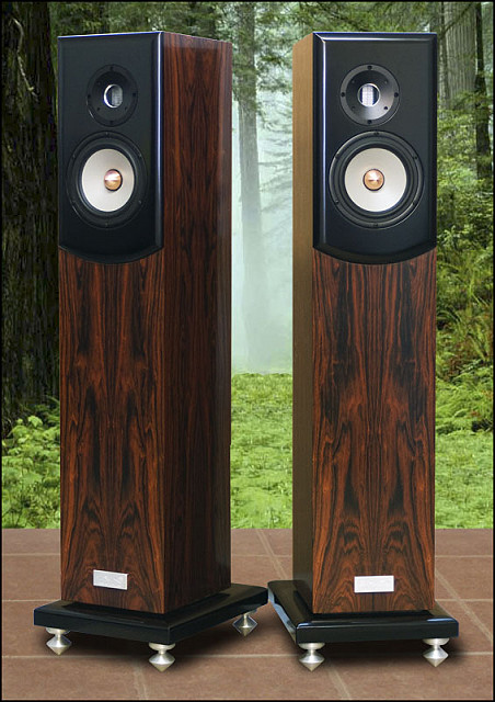

Based on the success of the HT2-TL's, we decided to re-visit an HT1 version of the same speaker.
We just finished work on this new design and will be showing it for the first time at Rocky Mountain Audiofest.  We'll then be taking it on the road to the Oregon GTG.
Here are some pics...

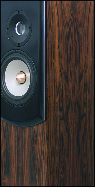

And a close-up...
This pair was done in genuine Brazilian rosewood and they sound as great as they look.
- Jim

I'm sure Jim pushed the quality-of-finish boundaries, and Paul Kittinger pushed the single-driver TL boundaries, but I just adapted the regular HT1 crossover to the different cabinet and sensitivity specs.  I haven't compared the HT1 and HT2 TL's in stereo, because I didn't have enough drivers.  The main difference is sensitivity--the HT1 uses the least sensitive version of the Seas W18, and there's only one.  So it's a little less sensitive than the regular HT1, and a good deal less sensitive than the MTM HT2.  There's no way around that if you're trying to maximize bass reach with one 7" driver.  MTM's and TM's always have a slightly different sound due to their different radiation patterns, but it's hard to put into words, and probably not enough to influence a purchase decision one way or another. I'll be very interested to compare the HT1 TL with the STRT at Denver.  I imagine they won't be priced all that far apart, so a lot of people might be shopping between the two

The HT-1 impedance is at or above 7 ohms up to about 2 kHz.  Then it dips down between 2k and 4k, going a little below 4 ohms.  I don't know whether that would be a problem for your tubies.  The HT-1 sensitivity is quite low--we're getting down into HT3 territory.  I would certainly prefer that you throw more watts at them than even your bridged tube model can provide.  The HT4 can also use as many watts as possible, but they're significantly more sensitive than the HT1.

They are 110's.  We played with a few LCY tweeters, including some OEM versions, and those seemed to perform the best over all.
