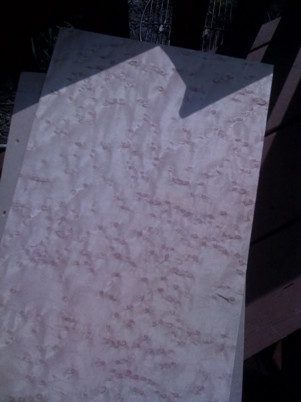

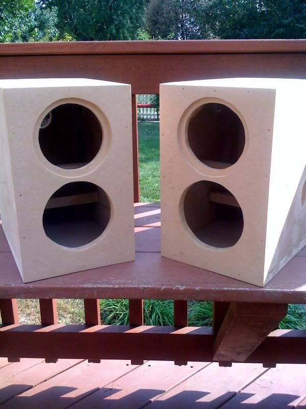

Here is a picture of the cabinets and the finished/unfinished veneer I am using.

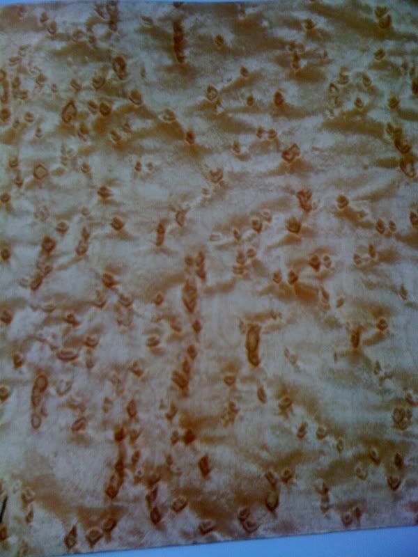

I took a small piece of scrap to practice my finishing and am pretty happy with the outcome. I just need to figure out what to do with the final layer to really make it pop.
pic of cabinet...
...and the veneer
Practiced finishing a small piece and came up with this.

I did notice a pro's veneer job. I think his name was Ron on here. His stuff looks awesome, but it looks like he possibly wrapped his box with a single piece for front back and sides. I was planning on a piece for each edge. am I doing it wrong, and need to order more veneer? heh.

 The speakers I built ( Neo 2X) have a 3/8" radius on the front vertical edges. I then wrapped the sides and front with a single sheet of 10 Mil thick real wood veneer. On the Neo 1 and Neo 1X, I suggest going with either a 1/2" or 3/4" radius. Also, suggest using neodyme magnetic grill fasteners too.

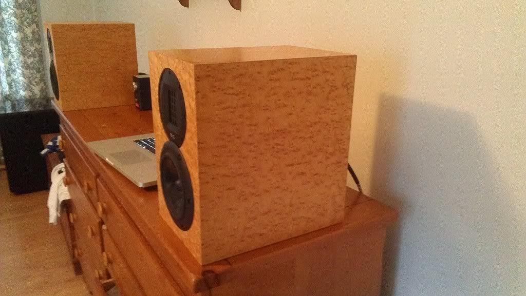

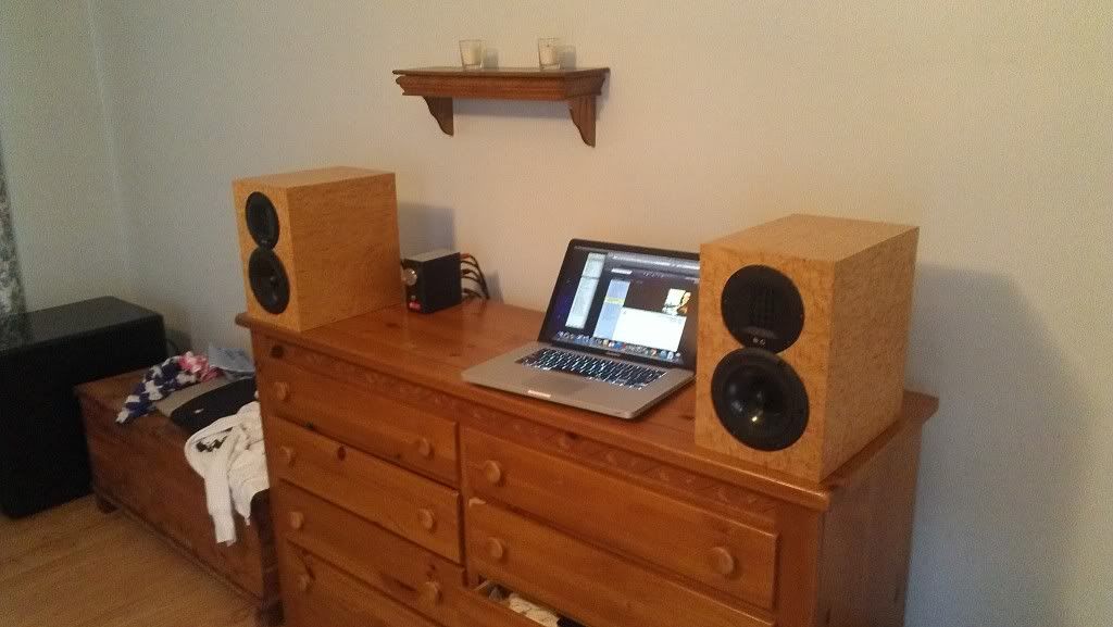

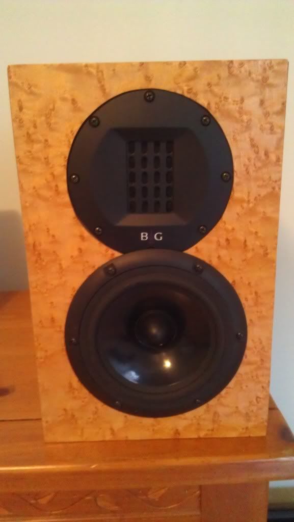

I realized I never got to posting the final product. These guys sound fantastic, I couldn't have been happier with the build.
Here we go...

Wow, those look really good!

What is that veneer called?

The veneer is birdseye maple. They look great in person. The one issue I had is on my left speaker the veneer split down the side. You notice it up close. Other than that though I have been super happy with them.
