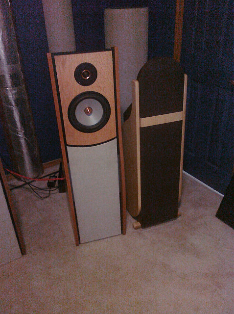

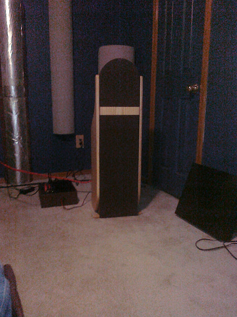

I picked up the Venuette's from Danny yesterday, here are a few pics of them in my room with my Orion's.
The Venuette's are 1 inch narrower than the Orion, 3 inches shorter and about 4 inches shallower,  the Venuette is 43.5" x 13" x 12".  I never thought of the Orion as imposing size wise but it is definitely larger than the Venuette.
I know you want to know "how do they sound?".  Well my first thought is the Venuette is an amazing speaker, but I will do more listening this weekend and get back to the subject of differences and qualities in a few days.
What I find interesting about these two speakers is commonality of open baffle and the goal of accurate sound reproduction, beyond that they share nothing in common.  The Orion uses "high-end audiophile drivers" and a active crossover, the Venuette uses pro audio drivers and passive crossovers between the mid and tweeter and active self amplification for the woofers.  And that brings out a very important difference.  The Orion requires a minimum of 6 channels of amplification, preferable 8, I use 6 on mine.  You either need a multi-channel amp or 3 stereo amps or .......  The Venuette comes with two mono amps for the woofer sections of the speakers so you only need to provide a stereo amp or two mono's.  The Venuette's mid and tweet drivers have a very high sensitivity so small tube amps can be used where the Orion requires much more power to sing.
On my Orion's I run a multi channel solid state amp with 6 channels at 150 watts per channel and my amp still has trouble with the parallel woofers.  On the Venuette's I will be running them with their provided bass amps and a Virtue One 30W/ch on the mid and tweet.  My multi-channel amp is a $4000.00 product, the Virtue One is only $270.00!!!!  Now if that does not get your attention I'm not sure what will.
As I said, I will post my impression of this speaker after a little more time, but with my friends, the Venuette is winning over the Orion 3 for 3.
