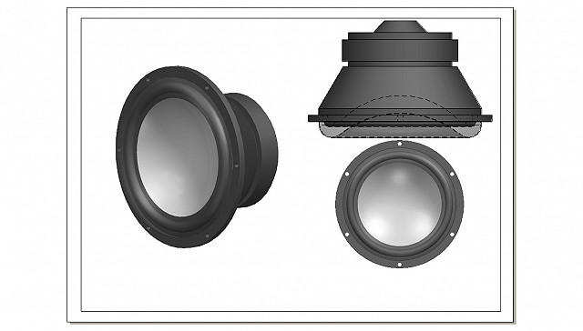

So here we go. These are some CAD drawings of my first specification 1801C's. Fairly simple but more to be continued...
Gerard

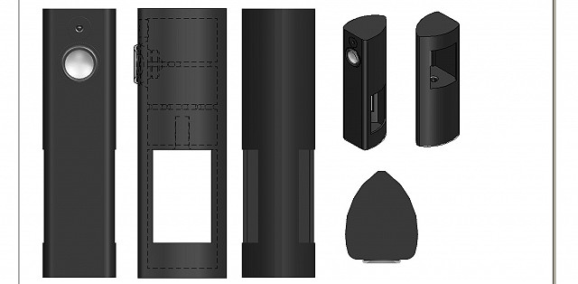

After spec 1. Came spec. 2.... Quickly skipped by myself....
Gerard

And one of my personal favorite design variations.... A slit front baffle. IMO that looks really nice.
Gerard

I'm still working on spec 3 with oval internal chamber. But I'm still doing basic calculations for that.
Who's next....
Gerard
