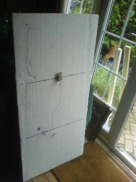

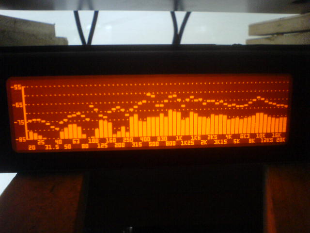

found this old test panel and cut off the wood with a bread knife ,don't tell er indoors!
a bit messy but will do.
this is about 2ft from panel.
this is about 12ft into the room,the lower response was peek hold but at about 4ft or so to the left resting on chair,the hf mirrors the top line well,all around the room in fact even to the side.
this is an old bog standard panel from my gallery for comparison .
not perfect but getting better,
steve

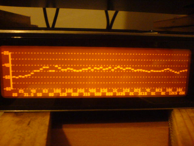

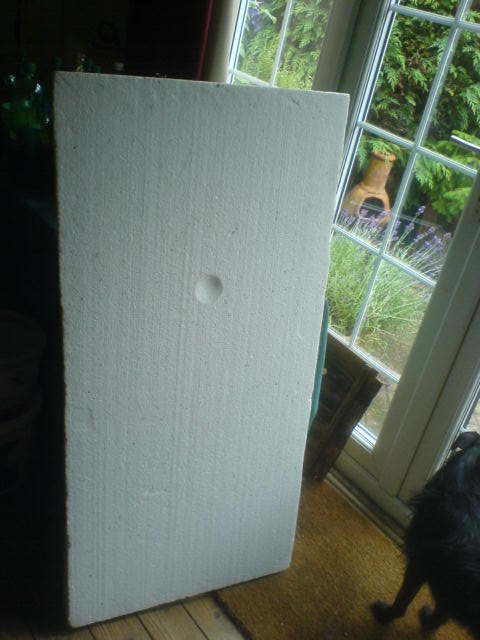

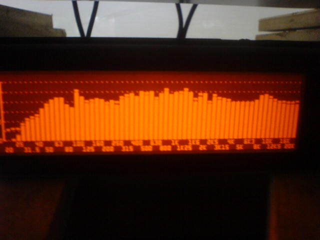

sedge
  • Posts: 385
Re: NXT.......rubbish??....THINK AGAIN!
« Reply #2475 on: 21 Jul 2015, 12:31 am »
I had so many problems setting up this panel, could not sort out the problems without ripping it all apart and starting from scratch, so mad do with what I had, I nearly gave up and chucked  it in the bin,but given all the problems not a bad response.
but the main thing is the sound improvement ,more up front and easy sounding.
all my pics are of a 30db window a 60db or more would look so much better but would not help me see the problems.
the exciter is in the centre of the width and 2/3 the height .
this was very slap dash but shows the hf above 10k is attainable .
steve
60db snapshot
