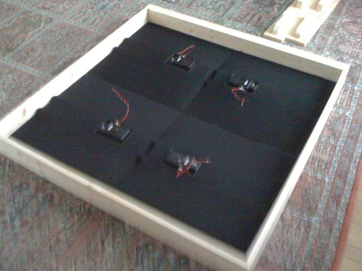

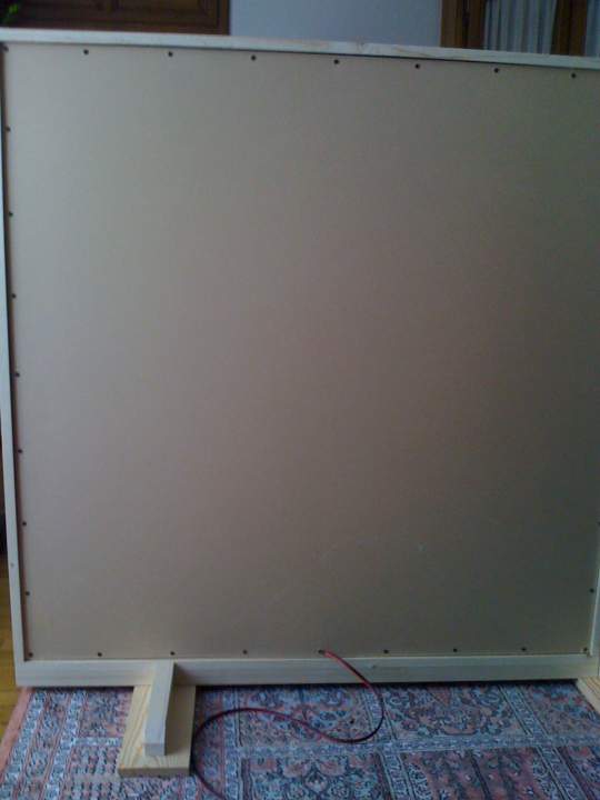

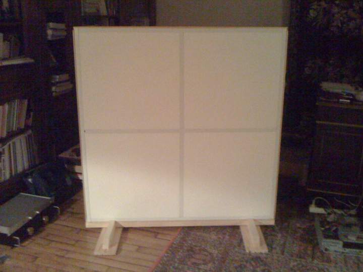

Here is an example of a couple of panels (only one represented) each made with four 2-Way tiles (one driver for highs and one for medium-lows)... Look here if interested http://www.parts-express.com/pe/showdetl.cfm?Partnumber=249-462
I must confess that the sound is not so good... I try them only for mids, but it isn't easy to match with the other drivers.
I think something is wrong with some materials and/or drivers for NXT panels. But I don't know what...

ondesx
Re: NXT.......rubbish??....THINK AGAIN!
« Reply #932 on: 21 Apr 2010, 04:08 pm »
Ondesx
Have you tried mounting  your panels vertically on a central  beam, such as a piece of 2by 4  say 8ft tall[ceiling permitting ] so that the edge of the panels are left to freely vibrate...
Hi Sedge,
Thanks for the input !...
Well, this is my first try with "commercial" panels including 2-way exciters.
I must admit that the tiles are firmly installed in the frames. And may be that is the reason why they don't sound as clear as expected (I did some experiments with single exciters and various materials leading to much better sound indeed, it remains a try with some honeycomb sample sheets I'm waiting for). I will try to "free" them a little, one of these days, to see what would happen.
But anyway I remain convinced that there is something wrong, since even the match with the other subranges remains an issue and that a simple dipole, respecting some very simple specs, will sound much better for less effort... Moreover, matching of dipoles seems to be much easier. Even with monopoles for very low frequencies isn't a drawback. That's why I'm working on an hybrid monopole/dipole design with an active configuration (both for amps and xover).
Stay tuned.
