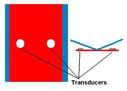

Here is one idea i thought of but i havnt tried it yet. I think i seen an image in this post somewhere of another production panel or somthing and it made me think of this, maybe it is already designed like this i cant really tell from the single image. I have noticed though that alot of the sound comes from the back and i wonder about the panel ideal loses alot of the sound from the back. Most traditional cabnet speakers take advantage of the back but panels seem to lose it.
ofcorse i wouldnt make it this color  :lol:

Then, you suggest a sort of Horn, isn't ?

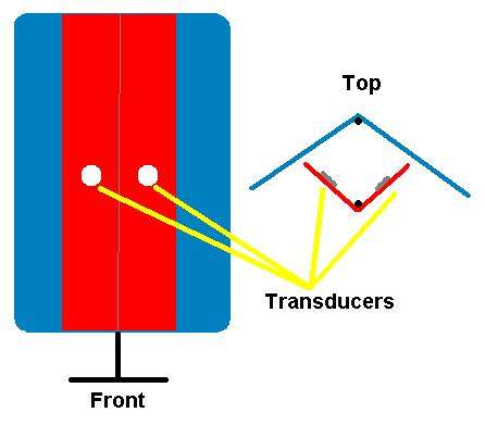

by using one single driver for the HF section and 4 on the big bad LF panel
we could get something nice and simple...
http://img42.imageshack.us/img42/6418/nxtpol.jpg

It seems that we are walking on the same path then... :D  I mean seriously, you have made almost exactly similar kind of findings that I have. Maybe we should start to work together on the next project then... ;)
There is of course many ways of doing the two-way DML loudspeaker but I have been also interested in concentric way of doing it. There is only very few rational ways of doing this and I have been thinking the following...
Two separated panels, almost exactly like in your sketch. This might be an easy way of doing it if you have a proper chassis that will allow this kind of structure. I´m little bit worried about the sensitivity of the center piece if we use only one exciter. Of course, there is a small possibility to compensate this with a super lightweight center panel (whatever it is...) but if you ask me, I think that it would be important to get the sensitivity of the both panel sections as close to each other as possible...
Other possibility is to make it a bit more traditional way. If we split the panel so that we have 1/3 piece for the HF section and 2/3 piece for the LF section, maybe it would be possible to treat them like a trad. loudspeaker drivers... HF section above the LF section, just like in a normal two-way loudspeakers. This way it would be easy to make a separated chassis for the both units if it is needed.
I think that I will make a prototype of the concentric version of the panel. It is quite easy to do and it will not take longer than few hours to make it to be a working prototype then. I have plenty of different kind of exciters so it is easy to find out which model is best for the HF unit and vice versa... :)

MIKADOSAN
It's allways nice to meet a guy who thinks about the same as you do...
It was only a drawing , I have already so much things to test with the large_range version
About the LF/HF split, we have to choose the frq of HiPass/LoPass
Law of 400 000 would suggests 666Hz, but those transducers don't go as low as 20Hz
so this is  probably not the best choice.
Usuable range starts somewhere between 100-200Hz up to 20 000Hz, this give us a median frq of 1.8kHz, one could take 2kHz in order of having about a frequency decade on each side of the Lopass and HiPass filters.
Though measures show a quick drop of frq response under 100Hz, I have noticed that my "feeling of bass" was much lower
I see two possible reasons, ear/brain reconstruction of fundamentals and sympathetic resonance of the panel itself, when excited with 60Hz, if the panel is large enough, he moves at 30Hz...
free lunch !
How about the LH/HF surface ratio? for a two ways, Frqs are in a 1 to 10 scale, so the surfaces should be in the same ratio, let's say 1 m² for bass and 0.1m² in the center zone for HF
the HF zone could be of different material than the bass zone.
The HF/LF ratio of 1 to 4 exciters, could be upgraded to 1 to 9 exciters, because in real world of music 90% of energy is located under 2kHz
POL
