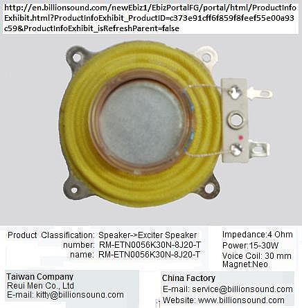

The panel must be as light as possible. The spinal support column as the Podium speaker add cost, may need reseach as it add a compliance effect, and do not work with the small 25mm Dayton exciter Zygadr and others have used, a free panel have lower FS than a fixed, it need a new bigger exciter that is unavaliable to us individuals, the China makers sell it only to NXT licensee firms by order from NXT Company.
This image below is a beauty Neodymium 30mm VC exciter with 4 holes to screws hold it at a colunm etc, This Chinese maker do not sell few units, only large quantities, but only to firms NXT licensee (no exceptios).   So the Dayton exciter is a bless to us amateurs.
Regards,
