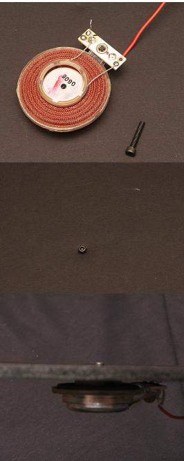

Glue? do you guys have the same units i have?  :|
Maybe this is why mine scream  :duh:
Scream bad? or scream good?
Bolts eh? who'd have thought?.
If you mean "scream" bad, I once worked in the stained-glass restoration biz and was occasionally required to dismantle broken panels which had been 'repaired' by sticking pieces of glass/plastic/wood/you name it over holes with silicon sealant, this crap was often almost impossible to remove in most cases, even after years, and I don't mean that it was just difficult to remove the last traces, I mean the 'patches' were nearly always a total b@5tard to get off AT ALL.
Slightly stretchy (vibration resistant?) but tough as hell.
I appreciate that anything compliant between the exciter and panel may reduce/alter the sound but perhaps a very thin layer would be ok?
I'm convinced that it wouldn't take much to stick good and strong, has anyone already tried silicone?
Does glue fail because of its rigidity?, or some other reason?.
