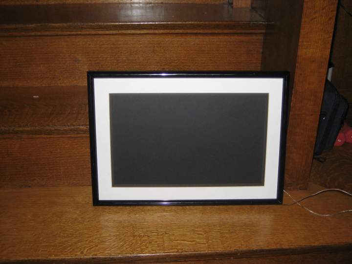

First of all just wanted to thank Ziggy for the all the work he has already done....ie made my life so much easier.  After just about 3 hours of work put in, I have fully functional speakers that would be acceptable in just about any room....aesthetics and a lack of bass always trumps no speakers at all.  I mounted 2 exciters in 4 salvaged frame each and ended up with a product that actually is respectable.  I so agree that NXT speakers have a mind of their own....ie no amount of actual planning will result in a perfect product...being an engineer i made that mistake :duh:. So by the time i actually got done with producing these i think the cost was under 40 dollars total, not bad for 4 speakers...I ended up sandwiching a hard foam board between the matte and the corrugated cardboard on the rear of the panel....I fell this gave it much better bass.  The foam and cardboard are held by four metal pressure bracket that actually allowed me to "sudo tune the frame".  I found that with out the large amount of pressure put on the board by the bracket the frame sounded very air and lack mids and bass.
Can anyone see any flaws in this design or significant ways to improve it....thanks

Impressive for your first post. :D  Nice looking panel and I can't say I see any flaws, but I know nothing about the tech end of these things.  I can say I like the idea and the look. :thumb:
I so agree that NXT speakers have a mind of their own....ie no amount of actual planning will result in a perfect product...being an engineer i made that mistake .
There is no perfect product, just different levels of quality.  I'm sure you realize that in all actuality.  I'd like to build something of high quality but only have a faint clue of where to start.  Any ideas on what panel features produce higher quality design?   Seems you broke many of the guidelines discussed in this thread in developing your panels.  Care to share from all your work?  What did you try and find?  Both will be useful to the community as a whole.  Maybe this can lead the rest of us to higher quality designs.
Thanks!
Dan
