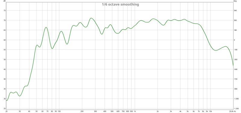

Hey there, I just registered to join the DML-panel-community. I am not an audiophile person but find the idea of a simple flat panel that fills the room relatively evenly with music quite interesting. As a computer scientist I did a lot of research but only little experiments so far.
The first thing that I noticed is that from the formulas, the bass should get better with a thinner panel. But when I build a 5mm thick XPS panel it had less bass then the same size with 20mm thickness. I found the solution to the contradiction in the free floating edges. In short, the panel gets to wobbly so the waves cannot travel far enough before vanished. The solution is a frame, which even increases radiation efficiency. I simply glued some wood sticks around the panel and wow, good bass!
So now I was ready to build my first complete DML-speaker prototype. For the experiments I was just holding the exciter against the panels. I decided to first build one with a 20mm thick panel I prepared in parallel with the frame-experiments. Front view is very simple:
The back side shows the simple construction:
I first build it without spline-mounting then latter added the spline. I hoped to improve bass but I don't notice any relevant changes in the frequency response. As the rooms in which I measured were different, the frequency responses had some differences anyway so there might be some little differences in spline mounting vs. free.
Frequency response:
After I EQed the highs up the panel sounds very good to me. Using a 12W amplifier with volume knob at around 1/4th the panel produces loud music I enjoyed listening to. So the 40W Exciter should have enough headroom.
Next I want to experiment with a DAEX13-13-4SM as tweeter to maybe get some more highs. And after that I have many other ideas I want to try but very little time. So it might take a while until a next prototype is ready. Stay tuned

Welcome Kame2.......Finally someone that actually read the post on this topic and is on the right track....Like Ive always said a spline and a FRAME is a must because it will make the panels sound better.
The DAEX 13 being used as a tweeter would sound best when used in the upper corner and with just a non polarized electrolytic capacitor at 4-6khz.
Good luck with your experiments.

Regarding the frame I recommend the paper 'The effect of boundary conditions and ribs on the total radiation efficiency of submerged plates': https://eprints.soton.ac.uk/369232/1/Eprints.pdf
While the real behavior of a free floating panel is not as bad as the paper suggests, it becomes clear that a frame is the better choice. As a simply supported suspension is harder to get right I went for the completely clamped version and just glued the frame on the plate.
I am not sure if a spline improves the sound in all cases. It should help if the magnet is not massive enough to handle the deeper frequencies. But I think in my case the stiffness of the plate prevents the deep bass part.
But independent of the sound quality I think it is a good idea to support the mass of the magnet of this heavy exciter.
In respect to the tweeter I am with you. For the high frequencies the location of the exciter should not be critical and as the lower frequencies have lesser amplitude in the corners they are a good place to reduce bad interaction with the (little) mass of the tweeter.
