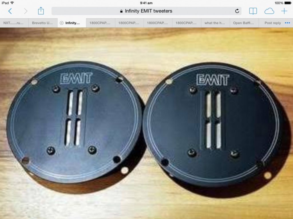

BW, a bit off-topic, but I am a sucker for that sizzle from the cymbals and hi-hats. I can hear it on my panels, but it sounds like they are a long way off at the back of the stage.
I have four EMIT Infinity tweeters from a couple of old RS7s  that I was thinking of using for top end sparkle. Quote from an old post on audioreview forum "EMIT's are not ribbon speakers. They are planar magnetics. Planar magnetic speakers have a voice coil printed on or attached/glued to a diaphragm.
The name EMIT means; electromagnetic induction tweeter." They are like a Magnaplanar panel in miniature.
The Virtually weightless diaphragm and voice coil are supposed to extend to 45KHz so if you like annoying bats...:lol:
So not DML spakers, but at least planar diaphragm. Not much piston behavior going on 6K - 45K

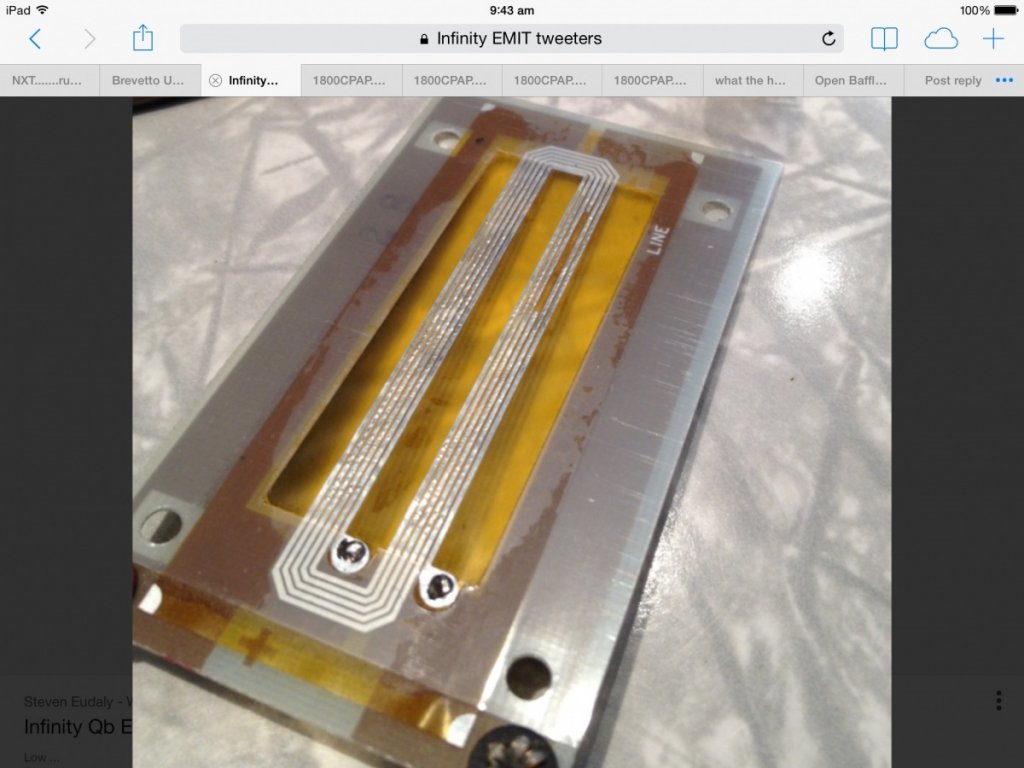

And inside
note break in voicecoil.
You can always get some silver conducting paint (used for repairing windscreen demister traces) or copper ribbon and put a voicecoil on the back of a  polystyrene panel...then some strong magnets...do it in one small spot and you have an exciter built into the panel.  :thumb:

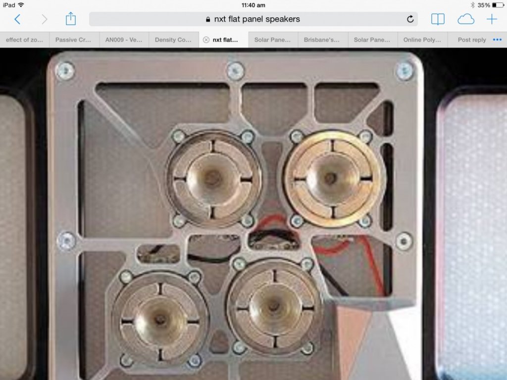

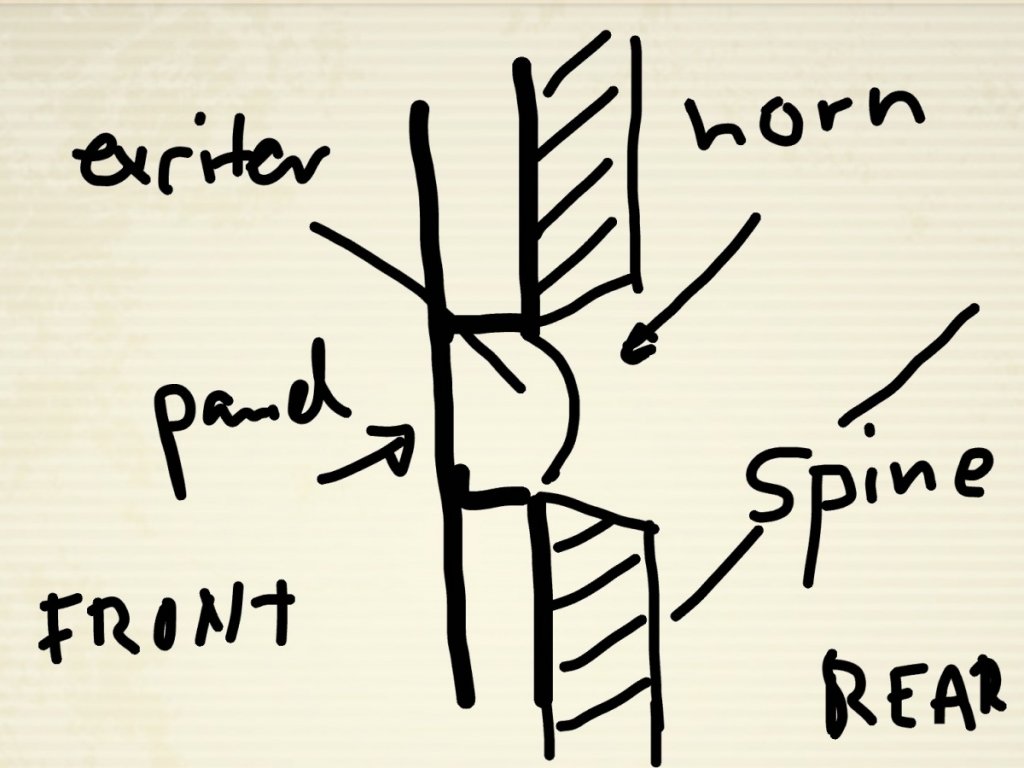

I noticed with some of the higher powered exciters that they have a horn or waveguide as part of the cooling vent.
I wonder if you could use this same idea to boost the output from the rear of other exciters. Scuse crude drawing, but you get the idea
Ozziozzi
No, guys, that "horn" has nothing to do with the sound, its just a part of magnetic motor assembly - magnetic flux conductor to the voice coil. When I designed my custom exciter with the simulation software called FEMM, I found that shape of the flux conductor is most efficient. Thats all about motor efficiency, nothing more. By the way, on the picture one can see the most efficient custom designed exciters. I guess DAEX25SHF-4 has the same design.

Ahhh so the exciters with just the single hole in the middle is just part of the magnet assembly, which I assume is totally different from the exciters with VENT holes.
oldschoolVlad
  • Posts: 30
Re: NXT.......rubbish??....THINK AGAIN!
« Reply #2978 on: 9 Aug 2017, 07:22 am »
Every single hole in the middle is a vent one, a horn shaped hole is a result of motor design.
