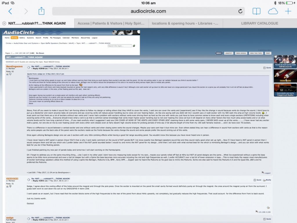

I must point out that telling people to cover up vent holes without warning them that doing so could destroy there exciter's and also melt the panel. It's like not putting water in your car radiator because you think it sounds better ?
The vents are there for forced cooling of the coils and to reduce noise ,bertagni new he had to reduce the temperature of his coils or he would be doing serious repair jobs to melted poly panels.
As for making all the difference to the sound from front to the back  :duh:
I have used exciter's with there vent holes blocked mounted on spines ,for test reason's only ,with very little difference in sound if any? Although a ten watt exciter will go down to 20hz and lower on a large panel,but if you mount the exciter on a spine you will probably find it will roll off fast at about 40hz .
Bertagnis work as a piston in this area ,a free floating panel as POL said,  does not !
Once again Having two exciter's on a single panel will interfere with each other( combing effects).
Tectonics use four exciter's to a panel ,and use two panels,the exciter's look as if they are using nxt positioning.
Tectonics minimise combing by xo ing to a ribbon tweeter at about 6k or so.
This would mean no combing effects above 6k.
Steve
Steve, First off you seem to make it sound like I am forcing others to follow my design or telling others that they HAVE to cover the vents, I said one can cover the vents and (experiment) see if they like the change in sound because vents do change the sound..I dont have to put up a disclaimer and (warn anyone) baby sit everyone and say covering vents will reduce power handling due to voice coil over heating faster...its like one saying well you didnt tell me I couldnt use a 3 watt exciter with my 500 watt rms amp at high volume levels  :lol:.. I must point out that there are a lot of exciters without rear vents and I never had a problem with exciters without vents even driving them as hard as the one with vents you just have to have common sense to know each and every single exciters LIMITATIONS including when covering some of the vents....Everyone should know what a vent is as that is common sense knowledge that vents mean higher power handling due to not over heating the voice coil but it will depend on many other factors like how much amp power/watts and or at what volume levels and for how long a period of time....If you read carefully what I suggested I said one CAN COVER UP SOME OF THE VENTS LIKE EVERY OTHER VENT meaning there is still some vents open, I NEVER SAID cover up all the vents..........I have never had any exciter melt a panel, nor one die on me by over heating (even with every other vent closed) even at fairly decent high volume levels for prolong periods of time say 3 full albums length of time from my 100 watt Yamaha receiver.... and I do have over 70 exciters.
There is a difference in sound between a vented exciter and one without vents and when closing some vents the sound changes. Maybe your ears cant hear it but mine can. Even others stated they can hear a difference in sound from exciters with vents as that is the reason why some people use the back side of the panel were the exciters reside as the fronts because the vents change the sound and some people prefer the sound coming out of the vents.
Once again utilizing Bertagnis design one can use 2 exciters with very little combing effects while having a good full range sounding panel. You wouldnt know this because you have never heard one in person.
I have never heard a NXT panel in person (have YOU?) that is why I cant really comment on the sound of NXT panels BUT I do know exactly how Bertagni speakers sound like and they sound really good when set up right....Now if I have heard a NXT panel in person then I would compare them and tell you which one I prefer better and if the NXT panel sounded better I would try and mimic the NXT panel for my design...Until then I will stick with what worked best for me which is mimicking Bertagni's design....and you can stick with what works best for you be it free floating panels.
I just finished painting my new pair of panels today and tomorrow I will start working on the frames/spine.
Oh I forgot to address you on the spine mounting thing....Like I said in my other post I dont have any measuring tools except for my ears...maybe your panels rolled off fast at 40hz but NOT all panel designs are the same....What Ive experienced without a spine the bass seems to be little more pronounced and even a tad bit deeper but with a Spine the bass becomes more accurate including the mid and high frequencies as well..I prefer ACCURACY over a tad bit of lower extension in bass....This is most likely the reason most manufacturers of exciter technology speakers utilize this method of using a spine like Bertagni, Podiums 0.5s, BMR , Sony APM.....Zygadr said he heard the Podiums so his goal was to mimic the Podiums. Some one else said he heard the Podiums 0.5 and the Quad ESL 280's and he preferred the Podiums.
« Last Edit: 7 May 2017, 11:34 am by Bendingwave »

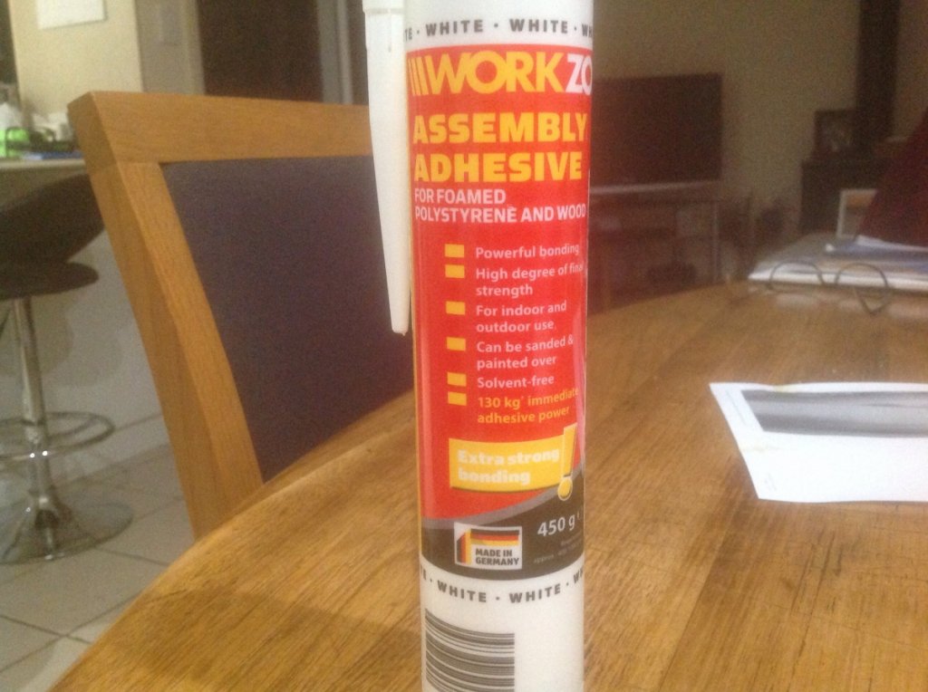

I thought people might be interested in this cartridge glue I found at my local Aldi store. It is especially formulated for expanded polystyrene and wood. So ideal for attaching XPS to various surrounds. $3.99 per 450gram tube and it should go a long way, especially if you use a thin bead or spread it with a bit of wood or plastic. Up to now I have been using water-based contact cement or PVA wood glue to stick XPS to other things. The cartridge should also make application easy. BTW it says on the label that you can sand it and paint over it when it dries. You can prime a surface with 2/3 adhesive : 1/3 water to increase bond strength, while Immediate bond strength is 130kg/sq meter.
Ozziozzi

Re: glue, what appealed to me is that it is sandable and paintable, which means you should be able to get a good finish even if you are a bit messy with application of glue. :roll:

I see the same thing on my end with the difficult to read page format. I believe it happens sometimes when there are some wide pictures posted on the page. Once we get to the next page of posts it will go back to normal again.
Re buzzing panels. If your panels are large enough, you should be able to run them much lower than 200Hz without any buzzing (unless of course you like your music at really loud levels.) The buzzing could be due to a lot of different things but could be a sign that something is not quite right - such as glue is getting loose from the exciter, not stiff enough panels for the volume and type of music you play, how they are hanging/standing, etc.
Try for example holding the panels in the top corners and hold them up in the air hanging loosely - still buzzing?
Before I used a proper glue, I got some buzzing from deep bass and shortly after I noticed the exciters were coming loose. Not saying that any of these are your issues - just wanted to share my experience :-)
However, I agree that you don't really get "slam" with panels and I also complement my panels with OB bass at the low end. I do cross them <100hz since I like the sound of the panel bass but I'm also using wood ply panels too so might (?) vibrate a bit different than EPS. I have played them much lower than that with no issues unless I play "subwoofer test track" type of songs
