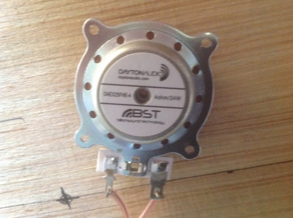

Complete 2.5mm plywood panel
Cuts around edge filled with silicone, not perfectly spaced, but maybe the randomness helps :)
Position of exciter 3/7 width 4/9 length as suggested by NXT
Exciter from Dayton
I have mainly been testing panel with 25W exciter driven by ~ 100W/ch receiver playing jazz piano and male vocal and cello and orchestra. Paul Grabovsky and Vince Jones "Provenance" album and "The Essential Yo-Yo Ma" CD. JS Bach's Jesu Joy of Man's Desiring sounds especially good on the ply panel. Little bit of buzzing on the lowest frequencies and really heavy piano crescendos, as I am running the panel fullrange with 3dB of bass boost at around 60Hz,  but the mids and treble are extended and convincing without distortion. BTW the exciter is not yet attached by glue and only has a couple of hours running time at fairly low voumes, so it may improve. Altogether I think this design is worth pursuing. I still have to build proper surrounds and foam edge mounting for panels to be incorporated in open baffle with helper woofer 31Hz to maybe 150-200Hz.
One question, does anyone have experience of using these exciters with and without a supporting spine holding the exciter? It has four mounting lugs which seem designed for mounting, but no instructions about mounting came with exciter.

The exciter looks like it might be a little heavy ,and might not be designed to support itself for long periods ,hence the mounting lugs.
Another problem you might have is the panel looks like it might have a bit of bowing ,ply tends to do this.
Using silicone as a filler between the exciter and a supporting spine might give a little support and a little flexibility in movement .
That is all I can think of at the moment,hopefully someone can come up with something a little better.
Steve
Thats what I thought. I was looking at aluminium U channel with hole to accommodate magnet and metal surround and small self-tapping metal screws to hold exciter mounting lugs. Maybe damp channel so that it doesn't vibrate and become its own panel.  One worry is that some posters have reported that exciters DIE after mounting to a spine, altho that may be delicate low power exciters not designed for spine mounting.
Yep ply is bowing and twisting a bit. It was almost flat until I applied 1:1 coating to both sides :( I was hoping that, when it is held in a frame it would flatten a bit, but that could be wishful thinking. While I was testing ply with exciter I put exciter down on a piece of polystyrene panel (ex broccoli box from supermarket !!! ) and it played a lot louder. I guess ply density is higher than XPS. Did you find the same result re efficiency? I may have to abandon thin ply because of this low efficiency despite ok sound. Fortunately the exciters I have are 24W so still a bit of headroom left., but I wonder when they start distorting from over-excursion or over-heating. At the levels I have been using magnet and metal frame do not even feel warm, but its hard to assess the voicecoil inside or movement of coil, spider or connecting wires to coil. Until they stop working !!!!!
This is possibly a good idea to mount semi- rigidly with some compliance to absorb any alignment problems between exciter and panel. Small rubber grommets either side of mounting lugs comes to mind. Have you ever seen inside vintage radios where speaker is mounted like that to prevent vibrations reaching metal chassis?
I have used that exciter for a long time on several different panels. I removed the adhesive tape and used glue instead to mount them unsupported on ply. Not a single one has fallen off, and I have never had any problem with heat even when playing loud.
I have had a few of the even heavier 40W exciters fall off when playing loud with deep bass, but never with the 24W ones.
I have never tried the silicon as a filler or other semi-rigid solutions so I can't comment on that (curious to see how it works out for you), but I had some problem with over-excursion when using a spine to support the exciters that eventually lead to the exciters fell off plus it didn't sound too good when it overextended. I never tried the spine with large wood panels but only with very small panels (think line-array using a couple of very small panels in a row) so maybe it would work better with larger panels that would require some more force to move.
Yes, using ply definitely reduces the efficiency a lot, but unless you want to play really loud it isn't really a problem. I like the character of the birch ply sound a lot so for me it is still really good (my preferred material). I use 1/4in which is thicker ply than you use. I found that the thinner ply warped and moved too much when playing loud.
Have fun and I'm looking forward to hear more about your panels!

The problem I mentioned about the heavy exciter was to do with the spider suspension sagging over time ,causing the coil to rub.
Even with a low efficiency panel xo in the 150hz region should help greatly .
With large (6x2ft) ply panels the efficacy is very low,using single exciters fullrange will get very hot ,too ho to touch,and will eventually melt the coils ,using LF boost will only make things worse ,if your exciters are staying cool you should have no problems.
A free floating exciter ,will happily try and play sub sonic input,this will on loud music make the exciters bounce wildly ,and because of the imbalance of the exciter (cable and connecting area) the exciter will also have serious wobbling going on, xo at 150hz, there will be no problem.
Obviously mounting the exciter on a solid spine will sort out these problems.
