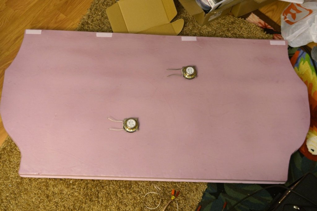

So, I've been working on my cargo-cover DML sub as time permits. Part of the challenge has been figuring out a way to mount it. There are slots for an actual cargo cover, but of course they are some specialized proprietary shape, and I'm not buying a whole cargo cover just for the little plastic pieces that fit. For the ones toward the front, I ended up making a mold and using Claycrete to make fitting pieces. I made them with a pocket for a 3/4" dowel. I have some speaker carpet Velcro'd to the top and bottom of the panel around the dowel so that it holds it up. For the ones in the rear, well, I haven't figured those out yet, but I really wanted to try it out tonight, so I just propped up the rear side of the panel on a box. I'll take pictures when I've actually figured out a mounting scheme that works.
Anyway, I did try it out a bit tonight, and it was a definite improvement to my system (aftermarket components up front). Now, I can't compare it to a normal car sub, because I've never had one. I've never been after boomy bass that'll wake up the neighborhood, lol, but as I've gotten into audio I've realized how good a balanced system sounds. I'm pretty sure I would not be able to get this panel to shake the house or anything, but I think it will be loud enough. I mean, there's no guarantee I won't burn out these exciters, since my amp can go well beyond their power rating (40W), but we'll see.
This is a 2x4' XPS panel 2 inches thick. (Well, it was 2x8' but I had Home Depot cut it to 2x4'.) I've cut it to fit into my hatchback, so the length ended up being 3-3.5'. I didn't need to cut the 2' side. The thickness was definitely helpful in getting more bass. The panel has two coats of Varathane Triple Thick Polyurethane (a water-based polyurethane). It stiffened it up, which also helps the bass.
I'm using 2 Dayton Audio DAEX30HESF-4 exciters, connected in series. They seem to have more oomph than the others I've tried (the DAEX25TP-4, DAEX25FHE-4, and DAEX32QMB-4). I'm using two to make the panel louder. They're attached with epoxy glue. When the panel is mounted, they are hanging underneath.
When I hooked it up, it blended really well with the front stage. The only thing I could localize to the back was some noise from the panel bumping against the dowel. (This was expected, as I haven't put any buffer in between them to prevent this.) Pretty cool!
I had my LPF set at 100Hz -- I liked it better than lower. But I only played with that for a couple minutes. I haven't played any pink noise or anything; there may be adjustments I make when I really sit down with it.
Here's a picture of the panel. It's definitely rough around the edges (literally), but I plan to cover it with speaker carpet to look nicer.
I might use the other 2-inch thick panel with my indoor setup. I've also modified those panels; the exciters had started peeling off a couple weeks ago. (I had only used the 3M VHB adhesive that came on the exciters.) So I reattached them with epoxy, but before I did that, I decided to coat them. Previously, they had a thin coat of watered-down PVA. Based on some smaller pieces I had experimented with, I gave them one coat of Varathane Triple Thick Polyurethane. The stuff is thick, but becomes dry to the touch a lot faster than the PVA mixture. Still, I left them overnight and glued the exciters on the next day.
It did smooth out the frequency response and make for less EQ. But they could still benefit a lot from a sub of some sort.
Edit: Well, I was playing the panel in the car today, but having the exciters unsupported underneath is a no-go. They fell off!  :roll: The epoxy didn't fail; the foam did. So I guess I'll need to make some sort of frame that will help hold them in place.
