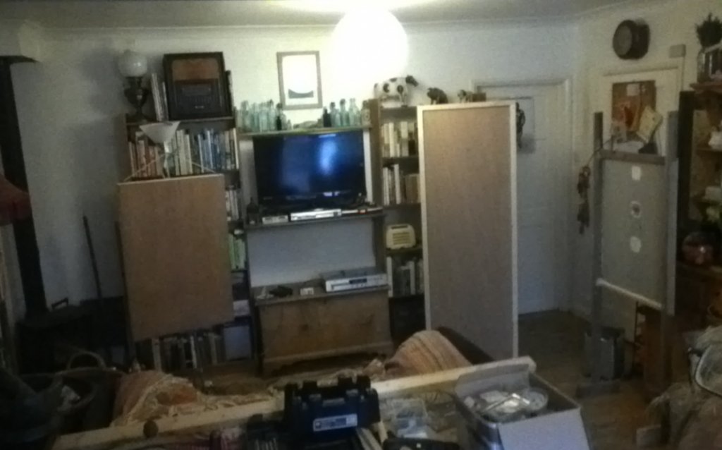

Am now entering stage one of this project, I have glued the exciter to the 6x2ft panel and now await it to dry ,so as I can move it out of the kitchen, hopefully it won't get knocked about!
I have used the monacor position and will see how it compares to the solidly mounted 2x3ft panel.
I will probably have to stand the panel on some foam pads as I don't have anything tall enough to hang them from ,I can hold the panel for short tests .
Will let you know how it goes after a few days drying.
Steve

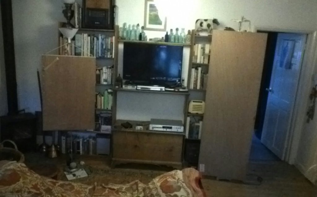

Had a quick listen today ,the first thing that was very obvious was the larger amounts of LF and the 4 to 5db or so louder volume ,this was from the smaller 3x2ft rigidly mounted panel,I had to turn down the volume on the smaller panel to get the stereo to give a central image  :thumb:
This is very handy as the exciter only gets warm when playing loud ,instead of very hot.
To my ears the smaller panel also sounds livelier ,but this could just mean that the larger free edged panel needs a more powerful exciter?
I managed to hang the 6x2ft panel in the end,so no problems resting on or touching anything.
When I get time I'll do some more listening,but so far they both sound very good.
Steve

Looks like my wife is going out to London for the day on Wednesday,so looks like that will be a good time to fit the solid frame to the 6x2ft ply panel !
Up till three in the morning again last night listening to both ply panels ,very realistic when playing simple live recordings made in a church,very difficult to turn off and go to bed  :o
Looking forward to seeing what happens when I solidly mount the 6ft panel ,will it have the same db output as the 3ft solidly mounted panel ?
Will it have the more lively sound as well?  We shall see.

I finally got the panel Finished ,I haven't used glue yet as I was running out of time, you know who was coming back from London  :duh: the output has increased but not sure by how much,will have to wait till I get back to my room.
I have increased rigidity by adding wood to the front of the panel as well,not sure if this will make any difference.
Steve
