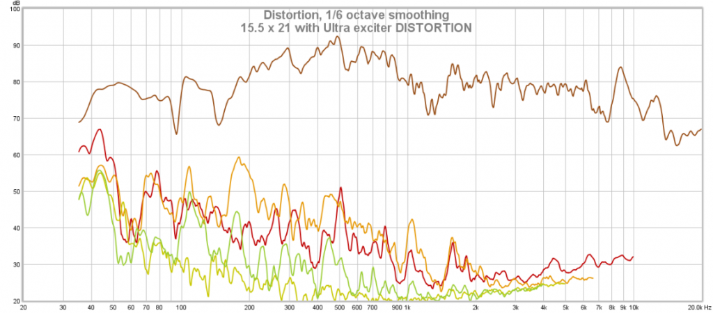

A few measurements:

I didn't mention in the previous post, this EPS panel saturates around 90-92dB... much earlier than XPS.  It doesn't take much power and the Ultra really manhandles it so a low powered exciter would do just fine.  I have a few of the Dayton Audio DAEX19SL-4 Slimline Coin Type 19mm Exciters (4W 4 Ohm) that I want to try for a smaller, wall hung panel.  With these EPS panels being so flippin' light, I think they will work fine. I want to finally put together a set of panels that I can use for HT... pretty stoked.  If we didn't have company coming I'd be working on them right now... arg.  :)
These are measurements with no EQ or sub... raw panel.  They go low(if you flatten the mid-range hump), but saturate INCREDIBLY early without high passing them.  So while they can go really low for such a small panel, their output is seriously limited.  I'm sure a larger panel would be fine.  :)
Yeah... the Dayton's are surprisingly good for the money... wasn't expecting much for $99 but exceeded expectations ... output is not mind blowing as you point out but very reasonable for a 8" sub!!

* Steve has at least one DML panel while I have many (big grin).  Mostly 3/4 to 1" XPS panels, but also cardboard, 1/8" birch ply and more recently... low quality 3/4" EPS.
* Sizes vary from 12" x 14.5" to x 24" x 30".
* all of my panels are single exciter but am in the process of building a dual panel array but still 1 exciter per panel.  I've never made a multiple exciter panel.  Odal has however.
* I've used a bunch of different exciters but mainly the Dayton Ultra (great on poly panels), Thruster and DAEX25FHE-4 Framed High Efficiency on ply.  There are others that I tried but didn't like nearly as much as these 3.  I have not listened to the DAEX30HESF-4 High Efficiency Steered Flux Exciter yet but have a bunch of them ready.  Odal has used them and likes them so I bought a bunch when they were on sale recently.  These exciters are cheap and fun to experiment with so I keep a number on hand...
Hope this helps!
