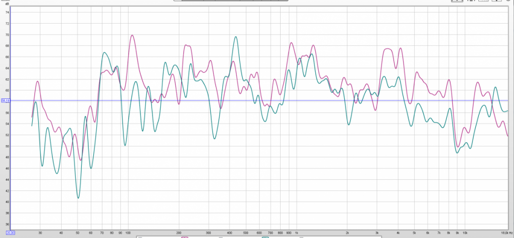

« Reply #2684 on: 1 Jan 2016, 02:59 pm »
Hi,
Here is graph for 900mm x 600mm x 3,5mm ply panels. Teal is with exciter on the dayton audio proposed position and the pink is one with around 2/5 from side and middle from top as I cut the panels shorter. Red is from dayton position when the panels were still 1200x600 sized.
Interestingly there is still the dip in 8-11k region and cutting the panels seemed to affect the LF suprisingly little.
-Ossi
sedge
  • Posts: 385
Re: NXT.......rubbish??....THINK AGAIN!
« Reply #2685 on: 2 Jan 2016, 12:56 am »
Osssyvan
Hi
Just a few questions.
What was the distance of the Mic.
Is the scale in 5db increments,it's a bit hard to see.
What exciter was used and how was it mounted.
Did you think the sound changed much between sizes and exciter positions.
Thanks for sharing.
Steve

osssyvan
  • Posts: 25
« Reply #2688 on: 2 Jan 2016, 07:32 am »
Hi,
Roughly 2m away. I did make too good comparison but both of them have sounded still fine. New charts are 2db steps. The exciter is
DAEX32EP-4.
I think the measurement spikes are not telling the truth. I have to figure out what is happening but I would guess that with that big jumps you would hear something is wrong but it is sounding quite nice. If EQ to max flatness they sound boring.
-Ossi

OB_Newbie
« Reply #2689 on: 2 Jan 2016, 06:32 pm »
Hey Ossi!
Unfortunately, this is the way these panels measure.  In my opinion, measuring with 1/6 smoothing is more telling of how they will sound/tonal balance.  It has been said that our ears are not as sensitive to dips in the response but can more easily identify the peaks.  This I believe make these panels sound very detailed.
I do agree with you that they sound more boring EQed closer to flat.  But then again, insert a smooth, well balanced speaker and listen... they are boring as well.  The panels still sound more clear and detailed, even after EQing, than most traditional speakers. But what sounds best to your ears is always what is most important...  we only need to make our own ear happy!   :thumb:

Interestingly there is still the dip in 8-11k region and cutting the panels seemed to affect the LF surprisingly little.
Even my tiny 14.5"x12" panels has roughly the resonance frequency IIRC.  The low freq. are not as strong naturally, but the Fs was roughly the same as the larger 24"x30" panels.  I will look for the measurements and post here in a bit...
sedge
  • Posts: 385
« Reply #2692 on: 2 Jan 2016, 08:20 pm »
Osssyvan
I too have been doing some head scratching ever since OB_newbie mentioned the difference between pink noise and I presume swept tone response .
You also say that you don't think your results are telling the truth!
This got me thinking ,so I measured my panels with a sweep test tone and would you believe it ,they differed mainly in the lower end,will post pic later if you wish.
But then I was looking at your pics and suddenly thought ,modal,what if as the single tone moves up through the frequency you are just measuring the panel modal resonances ,nodes and anti nodes.
I then went onto YouTube to remind myself about what happens when panels vibrate ,and found a vid called ,amazing resonance experiment, and the longer version ,resonance experiment,there's also one called ,the pyro panel,worth a look.
I'm thinking random noise could be better ,so as not to start up the resonance modes.
I always have my Mic and room analyser on and the response after playing lots of music usually matches the pink noise quite well.
Your thoughts on this would be greatly appreciated ,it's just a thought but what do you think?anyone.
Steve
