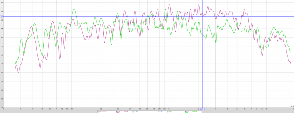

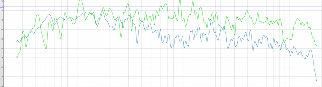

I brought back my ply panels and I really like their sound. I managed to measure my panels from around 1-1,5 m away. Not ideal setting but good to test them. My light frames did not survive the transport too well so there was some resonance. OB is from different location but my my there is some LF boost on that one. No wonder the ply does not sound right after listening to that for a while.
I will try testing ply with OB woofers at some point to see how they feel. I've also come up with a design I would like to do for the ply panels but I think I have to do some testing with different sizes to find the ideal. I think something more narrow but taller could work design wise but I am afraid what that will do the freq response.

Now they are showing. I did exactly the same thing than on last post. I was thinking of U-frame but I still need to think about that. I think I will have to google how commercial panel speakers look-like and see if there is anything interesting.
ply and treated xps
ply and ob

The difference between the eps and the ply db is even larger than the xps.
What with the heavy damping of the xps and the rolling off of hf on the larger 40w exciters, your measurements show the early roll off at around 4k to about -10 db at about 9k ,if I remember rightly,as I can't access pics at the moment,thinning the panel in front of the exciter area might help this by increasing the direct  output of the exciter,i have done this with the 5mm xps it's just a thought .

Hey Steve!  My measurements do not match my Omnimic measurements so these are not accurate I'm afraid... haven't had the time but got out the mic and did a quick measurement of cardboard and noticed that my (REW) preference settings were back to defaults and wrong.  Didn't have the time to get it completely sorted but have to think it was using my laptop mic... also the soundcard calibration is not right so have some work to do in REW yet.
Disregard the measurements and should only be used as a general comparisons between exciters and panel material.  My measurements from the other night showed much closer to my past Omnimic measurements with the typical, better HF extension.

It's not just your measurements that show early roll off of 25mm xps ,others also show this,even osssyvan,s last pics show early roll off above a 6k peak,can't see the db scale but it drops heavily,we really need to see some good plots showing hf extension to at least 10k without EQ ,the 25mm does this with no problem .
This is an old picture from my gallery ,it is a 25mm 2x5ft EPS panel with the Mic at 12ft into the room,no thinning of the panel in front of the exciter area,notice the drop above 10k then flat to 20k ,this I believe is caused by the thickness of the panel,you will also see the response from about 300hz to 10k is well within +and -2.5db with no EQ .
The ply panels I have also show high output above 10k ,so am surprise to see the drop in HF with osssyvan,s pics,this is why I am a little suspicious of the combination of 30mm exciter and xps ?
Hopefully some new measurements can clear this up
Steve
My old RTA measurements show the XPS and Ultras to be well extended... as did Omnimic.  In any event, I will have time over the holidays to get this straightened out.  But to your point, we will certainly get better high freq. extension with a smaller voice coil... absolutely no doubt.

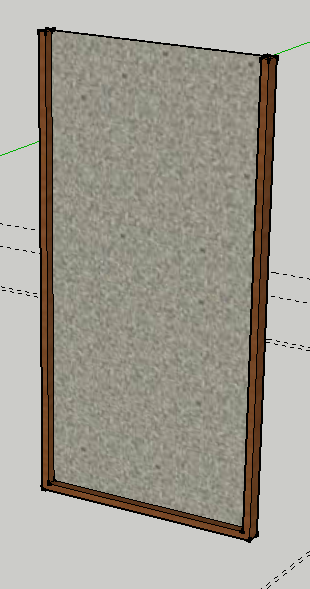

Ahhh, finally building a multi panel, framed and FINISHED DML panel!!  YES!

I will try to get some new measurements on some different place and distance. The ply has drop between 8,5k and 11k and then gets back up until 14,5k. I am going to cut the panels roughly to 60x90cm and see what happens. I will also test some exciter placements to see if I get any better results. This will have to wait after christmas I think.
There is of course the high chance that I don't have everything set up well in REW as I am trying to learn the whole process.
