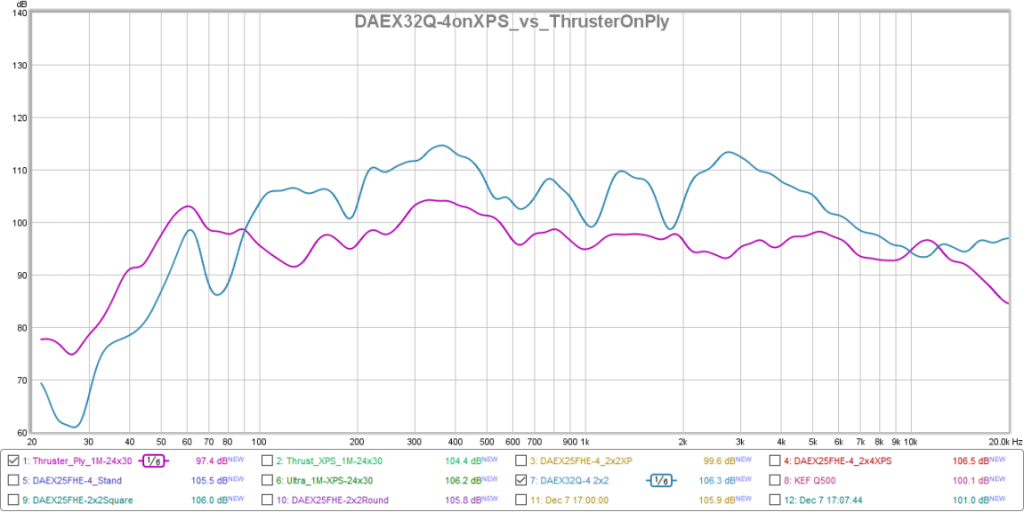

Here is why the DAEX32Q-4 doesn't sound so good...
This is on 2'x2' XPS vs. Thruster on 24"x30" Ply:

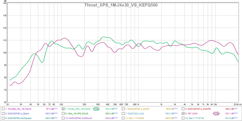

Thrust on 24"x30" XPS vs KEFQ500, 1 Meter, same mic position.

Very Interesting! But not sure what conclusions to draw from the KEF comparison- HF drop much sooner and faster as expected and perhaps mitigates the room better in the <200Hz.
What's your take?
Anything else that you could see with less smoothing applied?

If you ignor the floor bounce observed with the KEF, its much smoother and has a pleasant FR curve I would say.  Slightly recessed in the mid-range is more enjoyable to listen to for me.  It really is a very nice speaker for the money... they do nothing wrong and many, many things really well.  KEF has been a leader in driver technology and the Uni-Q drivers are no exception.  I personally like full-range speakers and the Uni-Q's have much of the coherency that I like from a high-quality full-range driver with better performance in the upper registers.
But on to the panels, the dropping high frequencies are compensated by the tilted up in room power response.  From the graphs I've seen, the power response peeks at 7.8db just shy of 16KHz.  I've EQed panels perfectly flat and can verify that the power response is indeed tilted up as the graphs indicate... very thin, bright and strident.  I began researching the best way to measure the power response of a speaker but it doesn't appear that there is a common, standard approach.  At the same time my measurement system developed a large peak around 60Hz with all measurements so got off track on this.  I also didn't know how best to measure DML's with their near Omni-directional radiation pattern.  Considering all of this, my interest in measuring the power response died with the measurement system.
Maybe come back to it later but for now I am trusting my ears for tonal balance and have been EQing the panels with that tilted down frequency response so that the FR and Power Response sum to a balanced speaker.  Whether this results in a perfectly balanced I can't say for sure at this point.  But have to admit, some of the motivation to purchase the KEFs was to serve as a reference so I can compare a pretty well regarded speaker to the panels we are building.   :thumb:
Have not switch back to the KEFs for weeks and weeks now.  The panels are more fun to listen to...I just enjoy them more and since purchasing the KEFs I am even more interested in improving these panels.  I want to built more elaborate panels in hopes to elevate the performance panels and their appeal to a more mainstream crowd;  less panel coloration, better balance with improved response at both extremes.
I really like what I hear today with my simple panels sitting on test stands but even small, steady improvements should help to take them to higher and higher levels.
