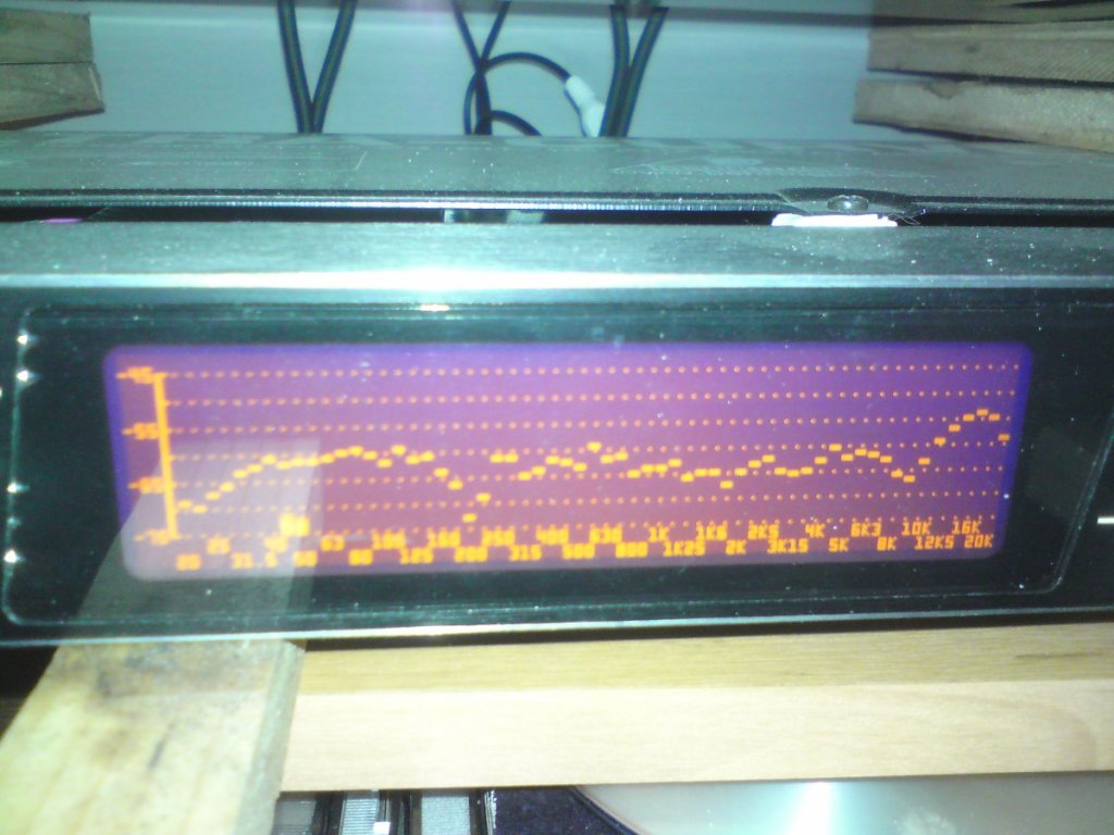

you mentioned the ply low end response ,this is a quick pic of my 3x2ft ply panel response at 12ft distance, it had to be quick because of the road noise at this time of day
steve

Hmmm, Steve... that sure is some elevated high frequencies?!?   At that distance my panels roll off slowly (but don't sound rolled off due to the DML panel's power response) at about 9KHz.
Is this in a really reflective room??

If you look back at pages 127 you will see the response in a different room which is about the same in the hf , also on page 126 you will see the response of the 6ft panel , I scratched my head for a bit ,then remembered the exciter was stuck on with double sided tape, I have always said you can loose a lot of hf if you use tape,and also detail.
Notice from the side pic of the panel the hf holds up.
The 2x3ftx3mm panel has a very smooth easy on the ear sound ,not offensive in any way,even with the peak in the hf which isn't very noticeable,to my ears anyway!
