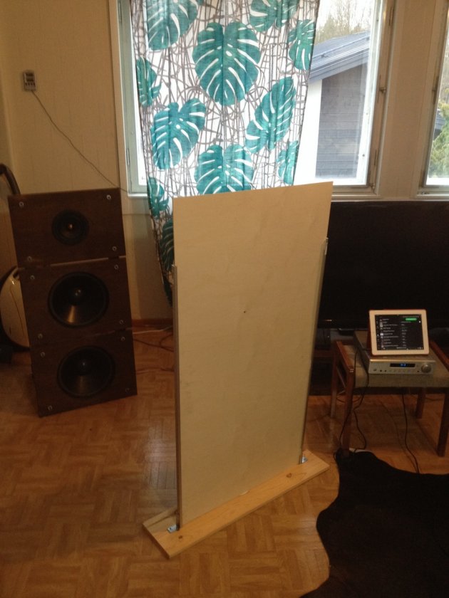

Hi everyone,
Decided to join you guys here. Been reading a while and experimenting a bit on DML panels on suggestions found here. So thank you guys!
I currently have 4mm thick (in reality 3,5mm) 600 mm x 1200 mm birch plywood panels in testing. I have to say that I really like the sound that you can get from panels!
My actual speakers open baffles and they sound a bit muffled compared to panels and the omnidirectionality of panels is great! The OB bass is a lot better though as the panels don't run low enough well enough. I don't have any measurement available but they seem full range to me. Some times the panels sound amazing on bass though and sometimes not so much. Haven't yet identified fully why or if it is due some specific frequencies.
I also have xps panels underwork. They sounded more detailed to me than the birch to begin with but very bright. The size is roughly 20mm x 600 mm x 1100 mm. I sanded them and rounded the corners and that already helped on the brightness and the sound. I will try the treatment with glue next. To me the sanding seemed to loose some of the stiffness due to missing the skin from the panel. I think the glue-mix would help on that actually. Also was thinking that some sort of lacquer might also do the trick.
I am planning on building some frame where I can insert different panels and use removable cloth covers to hide the monstrosity inside. Should be fun.
The exciters I have are the DAEX32EP4.
Here is pic of a birch test panel. I used aluminium profile and few pieces of window insulation rubber to suspend the panel. On the back there is also my open baffle.
I think I have to get some measuring device and DSP at some point to play more. I think 2 way with OB bass or sub + panel is the way to go unless some figures good way to make panel sub. Would UMIK, REW and MiniDSP be a good idea?
-Ossi

« Reply #2526 on: 6 Nov 2015, 05:18 pm »
Yes, another convert! :thumb:
Nice work on the stand.  Explain more what you hear on the bad bass. I'm guessing what you hear is either the limit of the thickness of the panel with the chosen volume combined with the effect that you have the panel grounded to the floor via the stand.
Try this when you hear the crappy bass response. Take it out from the frame and hold up the panel  in the air holding it by hand and play it again. Try to hold the panels with as few touch points as you can - for example one or two fingers just on the side. This may not fix the issue but should improve it. You then will have some reference on what to shoot for when creating the stand.
Getting it up from the floor and hanging it make a big impact on the LF frequency response. If you measure the response on a floorstandning panel you will see big peaks and dips in the frequency response. One fix if you want to use the stands is to create a vibration dampening solution between stand and floor but it's not as good as hanging them up. I have had good results with putting moon gel between cedar rings that is placed between stand and floor.
I use REW with a umik-1 and I'm happy with it. Never tried the minidsp boards. Instead I use a software based solution on a Linux box which give me full control and let's me use the DAC of my choice.

« Reply #2528 on: 6 Nov 2015, 08:48 pm »
I think they are sometimes lacking in body for bass. My OBs might emphasize them just a bit though.
