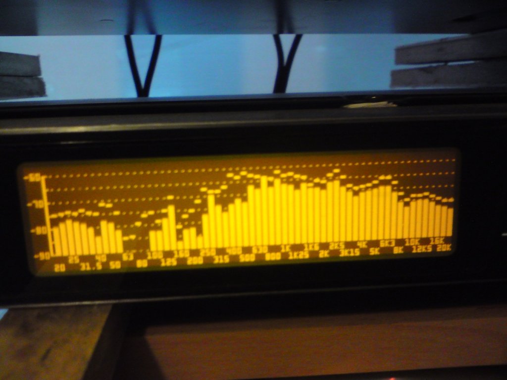

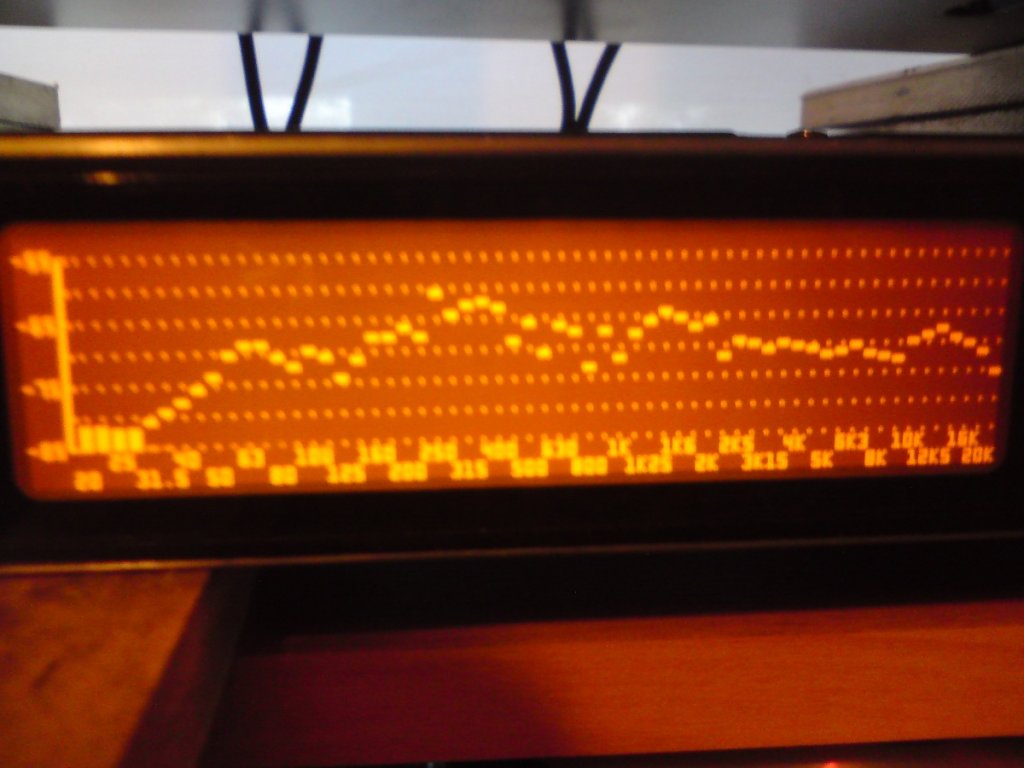

as a matter of interest ,I thought some people might like to see the response of different types of panel, so here is the fr response of a 6ft x2ftx1/8th inch thick ply wood panel at a distance of 2ft in front of the exciter, the exciter is stuck on with tape(for a short time anyway)with no foot , so the coil is directly mounted to the panel.

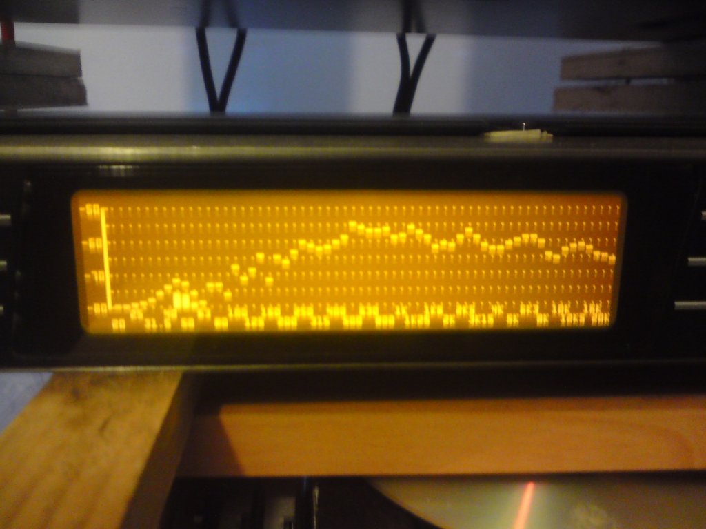

this pic is the same 2ft distance from the exciter but from the side(panel rotated not mic) I left the peek hold of the previous pic for reference .
as can be seen the hf goes higher (I was holding the mic while trying to take the pic and the mic must have moved off a bit but the peak hold shows the response ) while the rest of the fr drops off as expected .

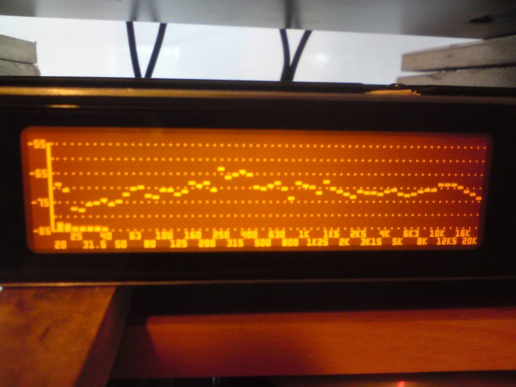

and same as before from the exciter side for completeness (panel rotated) this is a good full range panel but a more powerful exciter is needed than my 10 watt exciters.
this panel radiates hf in all directions , I presume the hf is louder from the side because the edge of the panel is 1ft closer to the mic?
hope this is of interest to someone.
steve

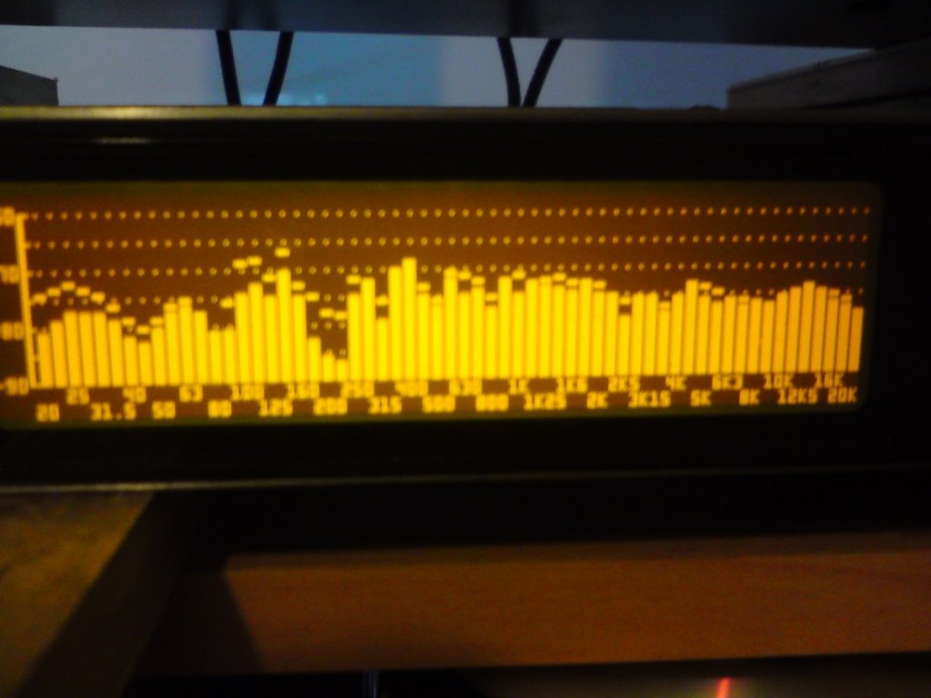

this is a pic of the 12ftx2ftx1/8th inch ply panel at a distance of 12ft, the hf holds up well , I also moved the mic 1ft to the left and 1ft to the right this filled the dip in the lower midrange but didn't alter the fr much above 250 hz

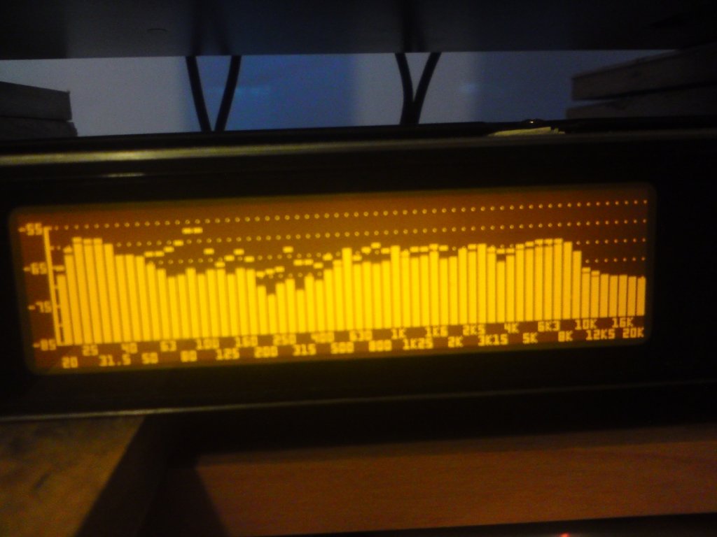

this is the response of a 5mm x86cmx60cm poly type test panel at 2ft .
this is the same panel at 12ft the hf has reduced ,but when I move the mic to the left and right the hf stays the same, I moved the mic all the way to the wall and the response above 300hz stayed almost the same but filled in the lower mid again,room problems don't seem to have much effect on fr above the lower midrange? whats left of my hearing tells me this panel has good hf but the mic says no?is this as you say room cancellation that the mono  mic is picking up but that my ears have no problem sorting out?

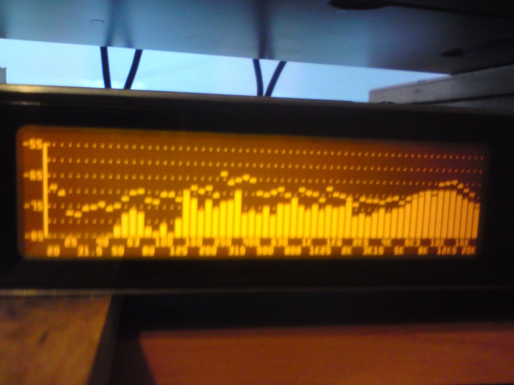

this is a bog standard 1inch x2ftx6ft eps panel at 12ft with some help from my tls up to about 300hz,  I have sanded it but not done anything else so far, i moved the mic as before left and right ,not much changes in the upper part of the fr plot again but once again the placing of the mic changes the response in the lower midrange ,the plywood panel does not suffer from this problem as much? I would describe this as fast and lively panel and would not be keen on using EQ to increase this,the sound is quite natural as is.but I will try my mods on this panel to see if I can bring it out naturally .
 steve
