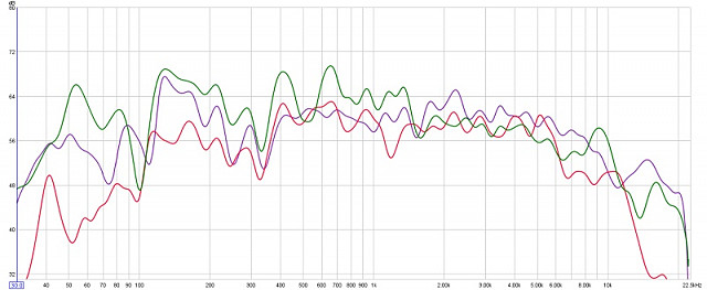

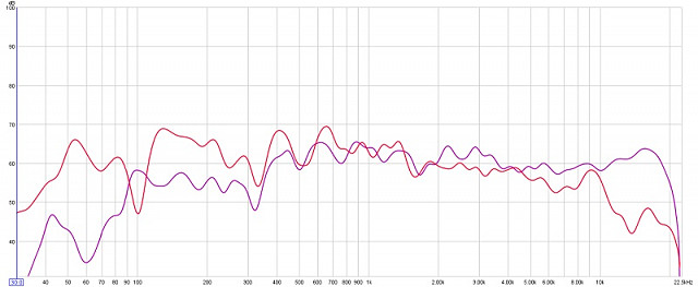

Donka
Re: NXT.......rubbish??....THINK AGAIN!
« Reply #250 on: 22 Oct 2009, 05:13 pm »
On the cheap exciters, the foot detaching form the voice coil is the most common failure I have had so far, but this is after a few prying and re-gluing or taping.  I have not had one fail from just playing yet.
I can also say that when running sweeps the panel will physically vibrate violently enough in low frequencies to distort in all methods tested so far, except with the framed panel with TBLR foam wedges.  This is what made me originally think the sweeps were causing an abnormal reaction so I went through and tested 40-50 individual frequencies on 2 panels to see if the lone response matched the sweeps, and they were very close.
The setup I have been using to test and listen to the panels is 2 x 3/8" medium density foam strips on the floor near the LR edges, then using a tripod with a strip of foam hanging from the head and a piece of blue masking tape to secure it from peeling off the panel.  This method has resulted in a very free to vibrate panel.  I also tested hanging panels by jacking up the tripod and letting it hang solely from the foam strip and the measurement were nearly identical, so I continued using the 2 strip floor method.
In conclusion the panel material really seems to depend on density.  In the LF range the panel must be able to immediately respond, it became obvious with the wood panel, that due to it's stiffness and slow reaction the exciters were moving on to the next octave before the panel could get moving to produce the previous.  This is much less so with the Gatorboard, but is stilll there and is what I believe to be the cause of the sort of rattle as noted by others.  Lastly the result of the sheetmetal tests seems to show the exciter is reproducing the HF range, and that it is the GF absorbing.
So, I setup all the test equipment again yesterday evening and glued exciters to various substances I had lying around the garage.  I the best sounding besides of course Gatorboard and then cardboard was 1/4" pressed core plywood.  I tested 1/8" aluminum sheet and it absorbed the most sound next to 3/32 plastic sheet which was the worst, however.  I then tested some 22ga sheetmetal that had no bass but produced the highs very clearly.  Overall I am tempted to try my Gatorboard panel with inset metal sheet tweeter.
I also got out a Yamaha NS-10M and did some side by side music listening, it was immediately clear the missing HF of the Gatorfoam panels.  So pulled out the old EQ and hooked it inline, gave them roughly a 6-7dB 6.3K and 16K and the panel fell right in line with the reference monitor.  I will also say I am not a horn/high-treble fan, I like a laid back sounding speaker, so don't think I am trying to tweek these panels to some overly hot HF level, trust me I am not.  I had time to listen to 6 Steely Dan tracks and played a touch with the EQ, it made quite a large difference.   I look forward to setting up the DCX2496 this evening, I believe it can save multiple parametric EQ's files and switch on the fly, which will make auditioning various HF levels easy.
Red Gatorfoam vs. Magenta Sheetmetal
Magenta 22ga sheetmetal vs. Black Garolite PCB board vs. Maroon 1/8" Aluminum vs. Orange Plastic sheet
Green Gatorboard vs. Red Carboard vs. Purple 1/4" Ply

I agree the plastic sounded the worst of all I tested yesterday, I think a more rigid plastic like polycarbonate still wouldn't sound good because it's density is too high.

Nice find as can be seen from that data sheet, the WHITE gatorfoam is more ideal to our cause with an elastic modulus 35% greater than the black.  Personally I think for availability and price this may be the ace in the hole.  $2/sqft is cheap compared to any of the sandwich and honeycomb composites out there.
