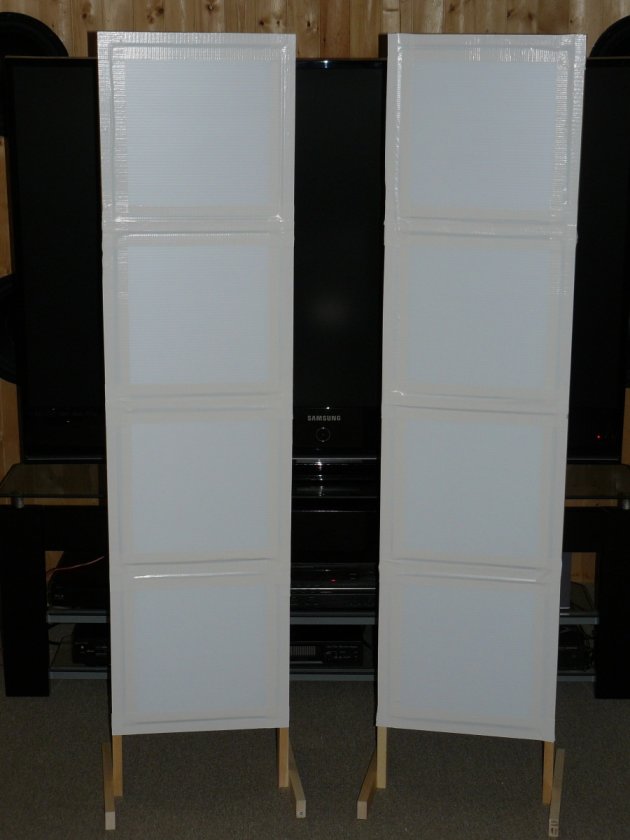

I haven't been on here for a while, but I thought I'd share a photo of something I put together a few years ago. It uses low power exciters, mainly because there was nothing higher wattage available at the time.
I used corrugated plastic panels floating in four separate frames and EQ'd the high end. Bass was very substantial to 50 hz, and sounded pretty nice on a wide variety of music.

Thanks for sharing the picture. Looks nice.  So do you have one exciter on each of the four floating panels? Are all full range?
captainjack115
  • Posts: 78
Re: NXT.......rubbish??....THINK AGAIN!
« Reply #2382 on: 4 Jun 2015, 12:44 am »
Yes, I forgot to mention that there is one exciter per panel. I discovered early on that using one exciter produced the best high frequency response, and yes, they all run full range.
The frame is made from 1x2's, the panels are held in place with white duct tape. There is a 1/2 inch boarder around the frame and the edge of the panels.
My listening room at that time was about 16 feet long, listening distance was around 14 feet.
Running pink noise my spectrum analyser showed bass was very good to 50 hz., with a fairly sharp drop from there.
Again while running pink noise and the spectrum analyser, I was able to move the microphone in many directions, left, right, up down. As expected, frequency response looked pretty much the same, proving that NXT technology actually works.

A curious thing, I did in fact make a larger panel version. or should I say the same number of square inches of all 4 panels. Bass was noticeably weaker, vastly lacking in tonal balance.
Maybe not such a mystery, as one exciter was connected to 4 times as much mass.
I think there's merit in using multiple smaller panels. it's not like stacking conventional drivers into a line array because a DML radiates up to 180 degrees. In other words, I don't think there is a comb
filtering issue here.
Big panels would be out of the question for me now. I moved from the East to the Mid-West after retirement and my listening environment is very cramped.
With this design I don't know how much would be gained by going taller than 4 panels. I have no proof of concept, but I see no reason not to make multiple panels double wide.
Arguing that vertical stacking presents no real world comb filtering problem, I can't see why doubling the width would produce beaming.
From what I can see the advantage here would be greater power handling and the ability to play louder with less distortion, especially since exciters with larger power handling capacity are readily available.
What's your take on this?

This is where I plead "guilty"!
The panels are 12x12 inches, the frames are made to allow a 13 inch opening per panel. I know.......I know, no golden ratio! Guilty on the first count. Also the exciters are mounted dead center, guilty on the second count.
There was nothing all that technical or arbitrary about panel shape or exciter placement. I simply ran pink noise into test panels of various shapes and sizes and tried moving the exciter around until the spectrum analyser showed the flattest response. The center was also the spot that sounded best to my ear.
How many loudspeaker "designers" have achieved their goals through empirical means? Plenty, I'm sure!
The exciters are freely mounted, no individual or common spines were used.

Yep efficiency was pretty good. I was able to power them with a little Lepai LP-2020A, no problem.
I too prefer the tall thin look, ironically my wife absolutely hates the look of them.
I experimented with Monacor's placement scheme and used 4 exciters on one panel. Excellent loudness, but things just didn't seem as good as one exciter per panel.
That's why I wound up with one exciter and multiple panels. The duct tape seemed to do pretty good at taming  corner vibration. The whole speaker is very light and easy to move around. Cheap and easy construction.

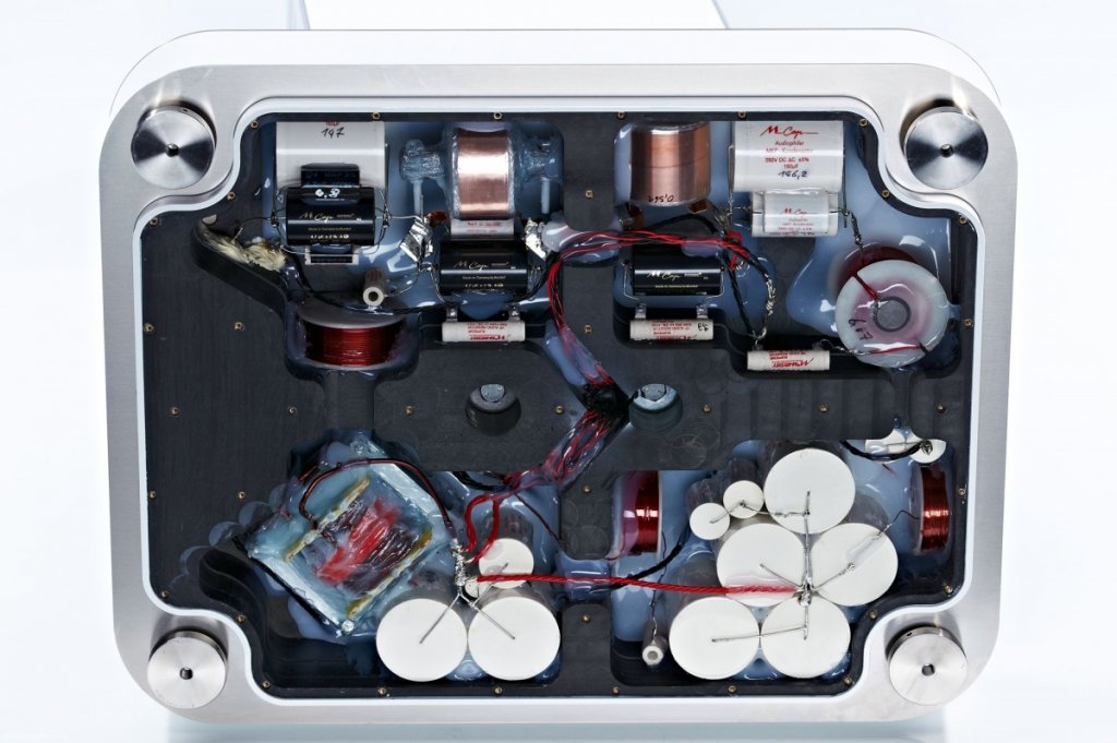

I found this photo of the Goebel crossover. Apparently it's not just for crossing over their bending wave transducer to their woofers. They mention that it's also for linearization of the bending wave driver.
To me that seems to infer equalization.
I can't help but wonder what Oliver Goebel's panel would do connected directly to a flat amplifier. They claim their bending wave device goes up to 29,500 hz. "Does it" or does it need some help?
Admittedly the fluted corrugated plastic I used is lossy, but high frequency EQ seems to work.
