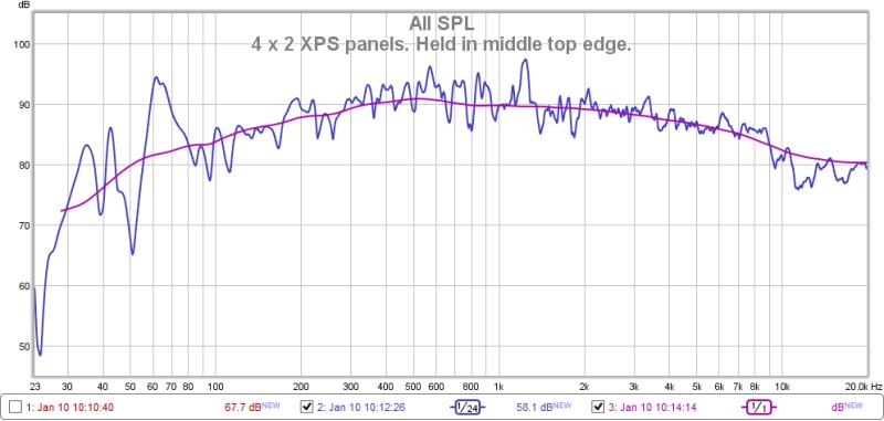

BTW: Here are some measurements of the XPS panels. Shows similar fall-off on the LF as the ones you posted - birch panels shows a much smoother LF, but the XPS has better and tighter high end. Mic at 3 ft (used the umik-1) - the lines shows the same panel but just with different smoothing applied.  Probably can't read too much into the chart because it is measured in my unfinsihed basement with concret floor, misc stuff and other reflective things.

BTW: The HF on the chart I posted could probably be improved if I used a different exciter (this was also the buy-out exciters) and used a harder glue instead of vhb tape.
